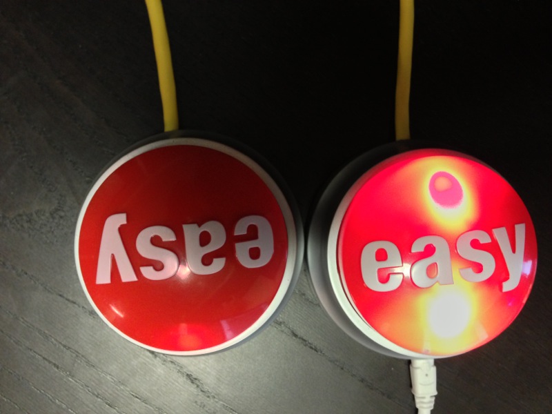

I built some 'game show' buttons with the usual Easy Buttons. I didn't take a lot of pictures from the build, but included is a reference to the session and some photos.
There are 2 LEDs in each easy button, which show though the button top. The lights can flash or fade in and out in an 'attractor' style mode. A button hit in game mode and the light stays on.
They communicate via rawHID to a custom Cocoa application written for the game which, in addition to controller the buttons and their lights and keeping score, pulls appIcons and uses some CI filters to distort them to facilitate the guessing game.

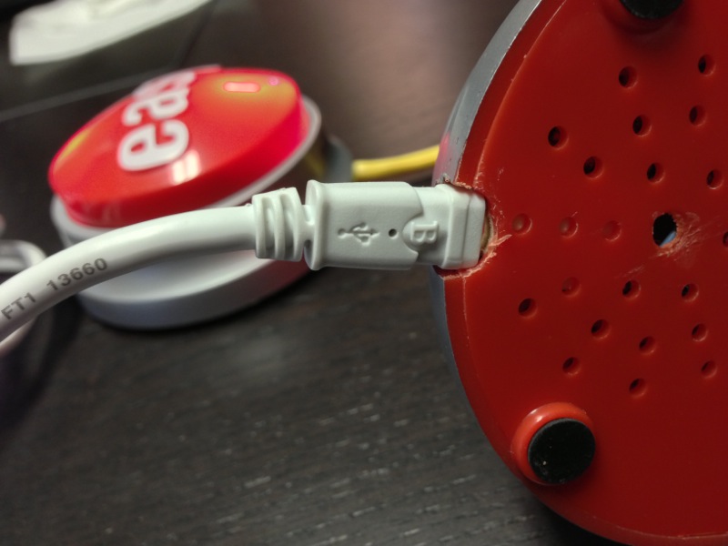

One button has the LEDs and switch connection raw soldered and glued in place, the other has the Teensy affixed to a piece of perfboard cut into a circle, and positioned where the speaker was in the Easy button. This plus a little foam tape keeps it from shifting when the USB cable is connected.
