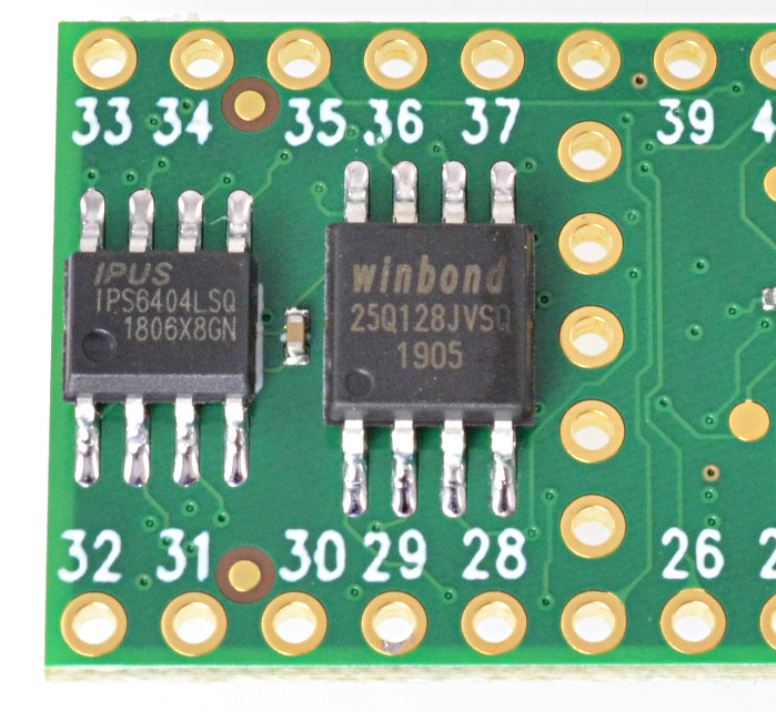

Teensy 4.1 also includes locations to solder additional memory chips.  The larger space is meant for a QSPI flash memory and the smaller space is intended for a 8MB PSRAM chip.
The IMXRT1062 microcontroller on Teensy 4.0 and 4.1 has 1MB of RAM built in.  For many real-time control projects, the internal RAM is plenty.  But some projects can greatly benefit from the added memory.  Frame buffers for high resolution TFT displays are the most common use, allowing advanced graphics rendering.  Large memory is also very useful for special audio effects like advanced reverb, buffering fast incoming data before logging to a SD card, and for emulation of retro computer systems like classic arcade games.
These extra memory chips have a dedicated QSPI bus, which is independent from Teensy 4.1’s main program memory.  When a flash memory chip added for storage of files or other data, this dedicated bus means it does not interfere with normal program memory access.  This is especially valuable while writing data or erasing sectors in the extra flash memory.  For real time projects controller motors, synthesizing or processing real-time audio, communicating high speed data or other tasks requiring low latency, flash writing can be done to the extra flash chip without blocking access to the normal program memory.
