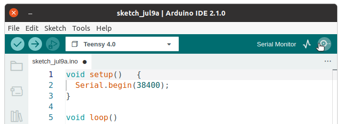

You can send messages to the Serial Monitor window on your PC or Mac, which is very helpful to see what your program is doing. Here is a simple example.
void setup() { Serial.begin(38400); } void loop() { Serial.println("Hello World"); delay(1000); }
Inside the setup function, "Serial.begin(38400)" initializes the communication. The number 38400 is the baud rate. The Teensy always uses USB speeds, so this number doesn't matter.
Then you can use Serial.print() and Serial.println() to send information. This example just sends "Hello World" every second.
To actually see the messages, click the Serial Monitor button (last in the toolbar).
The Serial Monitor window should appear, with these messages printing as your program runs.

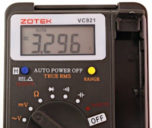

You can verify the circuit works by connecting a voltmeter. As with the RGB LED, testing your connections before writing code is good practice. Verifying the hardware works before you dive into the software can save time and frustration.
The voltmeter red lead connects to the group of 5 breadboard holes where pushbutton and 10K resistor meet. The black lead connects to ground.
Here is what you should see on the meter. The exact voltages may vary slightly, but should be close to 3.3V and zero.
Button Not Pressed | Button Pressed |
It may seem strange to have zero when the button is pressed and have 3.3 volts when it is released. This is called "active low", because the signal is low when the condition is happening. Active low signals are very common practice in electronics, especially for pushbuttons.
