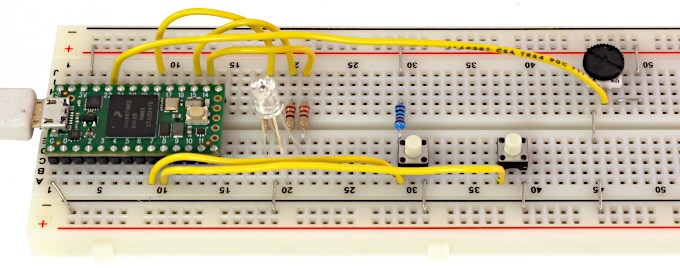

Connecting a Potentiometer

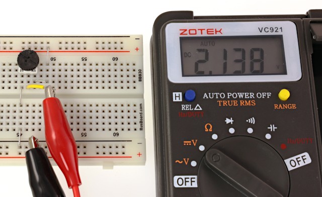

A potentiometer (or "pot") is a resistor with a third pin attached to a mechanical adjustment, so it can slide to any position. You can connect the outside 2 pins to +3.3 volt power and ground. When you turn the pot, the middle pin will have a voltage that corresponds to the position.
You can check the voltage from the pot by connecting a voltmeter, with the red lead to the center pin on the pot and the black lead to ground. Testing your hardware before writing software can save time and frustration. Turn the knob and watch the voltage change.
If the leads wiggle loose, you can bend a longer U-shaped wire and plug it into 2 holes, which will be much stronger when you clip a lead onto it.
The Teensy 4.0 has 10 analog input pins, labeled A0 to A9.
For this tutorial, connect the pot's voltage to analog pin A8.

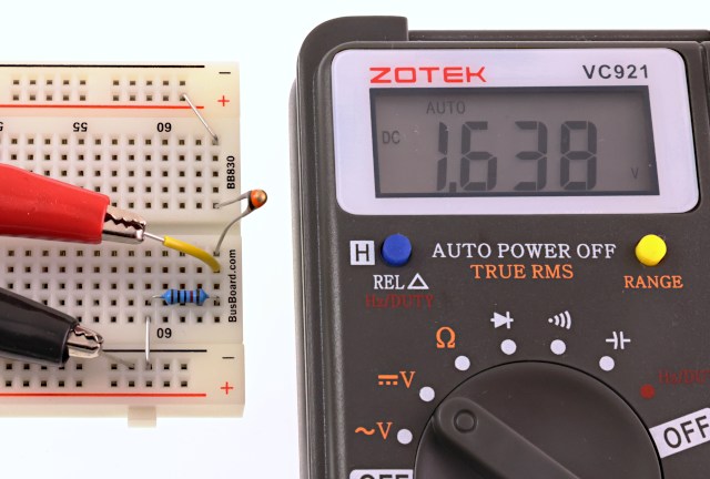

A thermistor is a resistor that changes with temperature. You can connect it together with another resistor that does not change, to create a voltage.
In this example, the thermistor is a Vishay NTCLE100E3103 which is 10K at 25 degrees Celsius and decreases in resistance as the temperature increases. At room temperature, the voltage should be close to 1.65 volts. As always, you can check the circuit before connecting it to your Teensy. If you touch the thermistor with your finger, you should see the voltage change.
When you are confident the thermistor is working, connect it to an analog input pin. In this example, it is connected to analog input A9.
