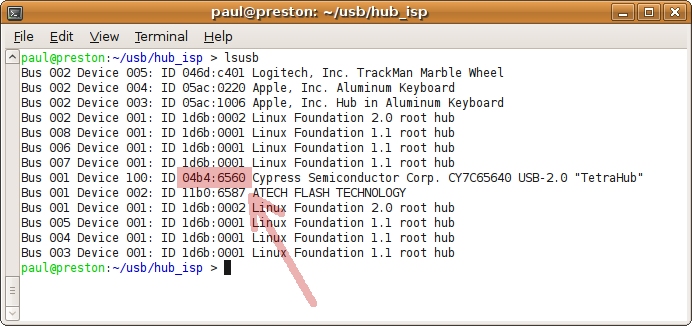

Before compiling, plug in your hub and type "lsusb" to find its vendor and product ID numbers.
You must edit config.h and include those ID numbers. Then just compile with "make". If you get an error about "usb.h" missing, you probably need to install a "devel" libusb library package.

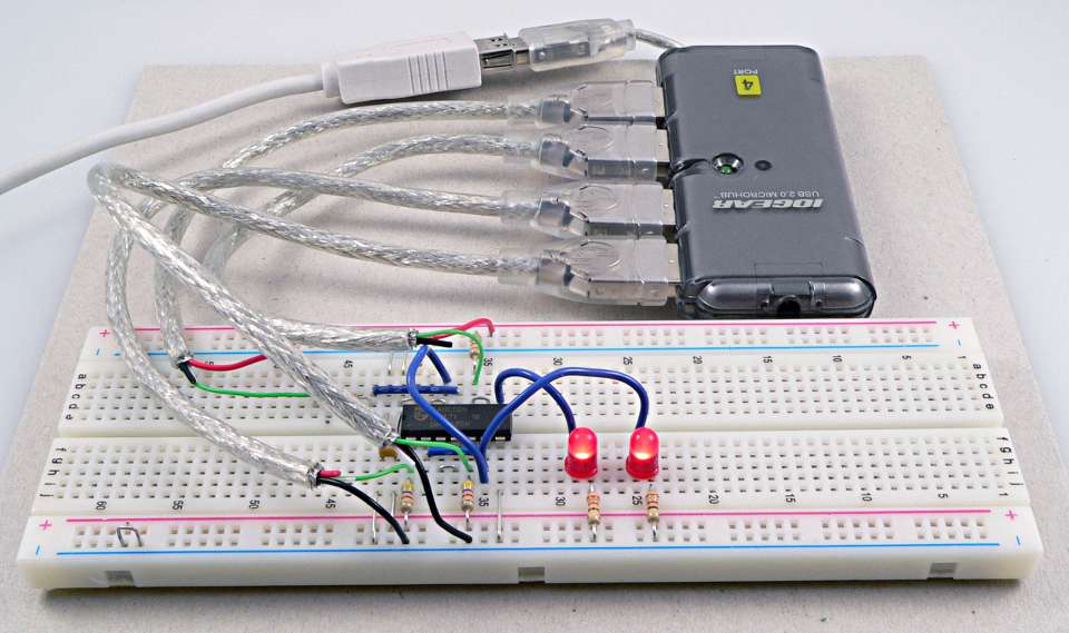

Here is a closeup photo of the circuitry. There is a 4.7K resistor, the one attached between pin 11 and port 4's green wire, hiding behind one of the USB cables!
This picture also has 2 LEDs connected to MOSI and SCLK, and a wire connecting MOSI to MISO. These are temporary, only needed for the test program.
This diagram of the 74HC00 chip can be helpful if you're following the schematic.
Be sure to add a 0.1 uF decoupling capacitor close to the 74HC00's power pins, and later when you add the AVR chip, put another one right on its pins 7 and 8. You're getting power through several inches of USB cable, probably the cheapest possible cables since you were willing to chop them up, and that power is coming from a hub which is probably also cheaply made, so please don't skip the decoupling capacitors. Use good quality ceramic (eg, X7R type) capacitors placed close to the power pins!
Taking a moment to secure the breadboard and hub to a piece of cardboard (or anything sturdy) with double sticky tape will save a lot of frustration. Those USB cables are rigid and the slightest motions seems to yank the tiny green wires loose.
When it's all wired up and looks like this, you're ready to run the test program.
Just run "hub_test". If everything is connected properly, you should get all tests to pass, and you'll see the LEDs blink as described. If any test fails, now is the time to get the wiring working properly, before you connect that AVR chip!
