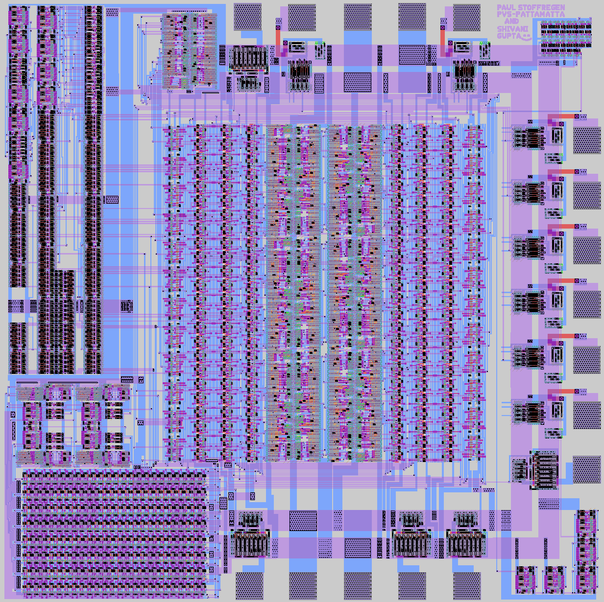

Fourth Order Low-Pass Filter ASIC
This IC, commonly refered to as "The Decimator", implements a fourth
order (sinc4) digital low-pass filter. The intended application
for this filter is to process output data from a multi-bit sigma-delta
modulator, thus completing a high-resolution A/D converter system.
The entire design was completed in approximately 10 weeks
in the Fall of 1993 by me (Paul
Stoffregen), Shivani Gupta, and Srinivas Pattamatta as the project
associated with the OSU-ECE graduate VLSI design course (ECE 517) instructed
by Richard Schreier.
This full-custom CMOS layout was drawn using the CMOSN lambda-based design
rules. The layout preview shown here is also available in
medium,
large,
and huge
sizes. After the course, the chip was fabricated by MOSIS
using Orbit's 2um P-well process on a tiny-chip (2.2mm by 2.2mm) die.
All four chips fabricated by
MOSIS
were tested (at only moderate speed)
using a microcontroller to feed data into the chip and collect the
output. All four chips produced correct output results!
