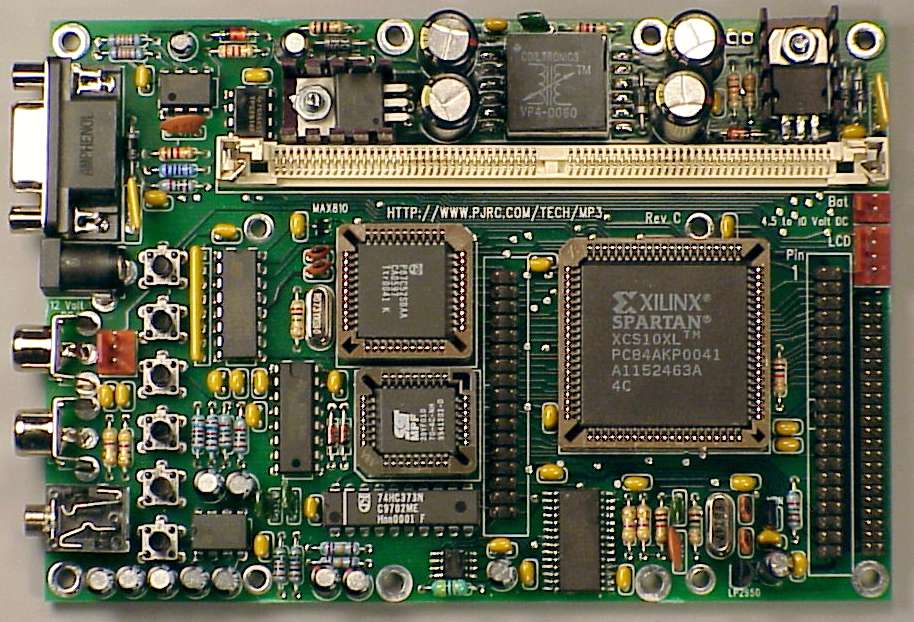

![]() Here is a larger photo (120k). We'll be shipping boards and kits tommorrow, and this first small batch should cover most, if not all of the backorders. I'll be posting info about the new rev C to the technical docs section over the next week, but for now Robin and I are tired and need to take a little break! October 10, 2001: Well, I've missed the deadline to get the first 20 rev C boards made by Saturday (Oct 13), but it looks very good for getting them sometime next week. One really positive thing that's come out of this long process is that I've finally drawn a reasonable schematic for the first board. Well, it's missing the pushbuttons and serial interface, but that'll be easy to add. Getting all those connections checked was a lot of work, as you can see from that image. I know there's a good number of people (several are students) who've been waiting for the schematic for quite a while, so enjoy. Rev C makes only a couple minor tweaks to the main schematic, so it'll be relatively easy to get a complete rev C schematic up by the time we're shipping boards. Also, I should mention that I've fallen behind in answering emails (worse that usual...) Please be patient, I will try to answer them all, probably next week while the boards are getting fabricated and we're making the inevitable last-minute orders for a few missing parts. October 4, 2001: It probably seems like I've dropped off the face of the earth... no updates to this page, not much happening with the firmware lately, ran out of mp3 player circuit boards, etc. Well, here's a bit about what's been going on lately. We ran out of boards about 5-6 weeks ago, and once more I was faced with the decision, "should I just make more of the exact same board, or should I try to improve the design". As you may know, I've never been 100% happy with the power supply part of the board. Rev A worked, though not nearly as efficiently as I wanted. Rev A also has a 4.5 to 6 volt input, and it was easy to damage the board by applying more than 7 volts to this input. I made some minor changes to create rev B with a sturdy 6 to 10 volt input (in addition to the 10-15 volt input), and the change reduced the heating in the TIP102 transistor. Still, it seem like it ought to be possible to do better. Well, it isn't easy. Over the last several weeks I've made multiple attempts that turned out to be dismal failures at a better power supply. I was about to give up. I took one more shot at it, and finally a result that I think is pretty good has come about. Here's a photo of the prototype:
![]() This supply uses a lot of the same parts as rev B, but the performance is considerably improved. The higher voltage input is still 10 to 15 volts, with protection from the nasty spikes from a car's alternator. The low voltage input is now 4 to 10 volts, which means rev C will be able to run from four AA batteries like rev A, but will be sturdy like rev B. Rev C's battery input will be much more efficient that either rev A or rev B... I wanted to be close to 100% efficient, but that's nearly impossible for a supply that can step up or step down as needed. I made many attempts to get really high efficiency, some using lots of expensive parts, but in the end none worked really well. I talked with a guy who's an expert at switching power supplies, but all his ideas revolved around complex custom transformers and inductors. I tried contacting some of the companies that make these. Most won't touch it for under 5000 parts/year, and those that will are very expensive for qty 100-200. So it looks like the standard parts (Cooper/Coiltronics) will have to do. I think this rev C supply is a good compromise and it keeps the cost and total size about the same as rev B. One of the major changes is a new PWM control chip. This new part (TL5001) includes a sort start limiter, which will eliminate the problem were the board can trip the current limiting that's built into many lab bench power supplies (not an issue for batteries and "wall warts"). The new switching supply makes only +5 volts, and a LP2950 linear regulator makes the 3.3 volts. Creating only +5 volts allows the supply to make better use of the transformer, and I switched to a somewhat smaller transformer (less magnetic material = lower losses is the core, which more than makes up for the small loss in the LP2950 for 3.3 volts). I also did a little trick to use the flyback voltage to create a little higher drive voltage for the mosfet, which really helps reduce the heating in the mosfet (and improve efficiency) when the supply is run from only 4 volts. There's also an undervoltage lock-out and a max duty cycle limiter so that the supply acts much more gracefully as the battery voltage falls below 4 volts. I also overhauled the circuit that muxes the 12 volt and battery inputs and protect from car alternator noise while preventing the battery from seeing destructive overcharging. The rev A and rev B versions used a diode in series with the battery, which really cuts into the battery's run time. The rev C design uses a P-channel mosfet (it's on the bottom of the prototype board) to eliminate the loss from that diode. I think that's most of the changes... all in all, it's quite an improvement over rev A and rev B. Though not as ambitious as my first couple (failed) attempts, I think it's pretty good and it'll fit into the existing board size without changing the cost of the board much (we'll keep the price the same at $150). A major frustration in this project has been the CAD software. The program I used for rev A and rev B is having a lot of trouble (corrupted files, bogus gerber output, etc). It really sucks to have to redraw an entire board with this many connections, but that's exactly what I had to do. Luckily I have access to some better software now, which has its own set of minor problems, but at least it seems to have a solid database and file format behind it. I'm going to avoid mentioning names, but I will say that the really problematic program was one of the really inexpensive packages. I guess you get what you pay for... So the big question is when will these rev C board be available. I wish I had an exact date. Today the new transformers finally arrived. We're still missing some of the important parts, but have a small number of them left over from rev B. I talked with the board fab company and they can get us a small number of boards in a hurry (for an extra fee, of course). We're going to try to get the first rev C boards and kits shipped on Oct 15. I know we have a few folks waiting who're using the board as part of a project with an urgent deadline. We're going to try to ship to them and the people who've been waiting more than 2 weeks. We'll get the rest of the boards and have them built later in the month... so hopefully we can have all the backlog taken care of before Halloween (Oct 31). I probably won't manage to get much done on the firmware until the boards and kits are sitting in stock and all the orders are shipped. One exception to this is the display beta test. Tom did a lot of work on the display firmware a couple months ago, and I made some small changes to fix the 2-pixel-shift bug and other random drawing bugs. Tom's new code includes some changes to make the display update better with less communication bandwidth from the player, but there's one more bug in this new code that prevents it from really improving the redraw responsiveness. Tom has been on a vacation for a couple weeks but recently returned. He'll probably look into this soon, and either way I'll do some work with the display firmware so that when we have the board again later this month, we'll have displays with the new debugged and improved code on them (the display is not easily upgradable like the player is). So that's more or less where the project is at. I am alive and well, but quite busy trying to get everything put together to finally have rev C boards available. Hopefully next month we'll have plenty of boards again and I can get back to working on the firmware and doing much-needed updates to the web site. August 24, 2001: It's been a few weeks since I've added any updates here. I'm going to try to get an update up here at least once a week. It's been almost exactly 2 months since the firmware development was moved to CVS, and during that time several people have come on board and really helped fill out a lot of the player's features. Ian did quite a bit of work to add items to the display, including interactive tone controls. Zach added code that scans all the directories on the drive. I overhauled the device drivers to speed this up, and Matthew has done quite a bit of work to optimize this. He also began some of the initial coding to be able to read .m3u files, but much remains to be done there. Matthew also made several valliant attempts to make that code non-recursive (allowing almost limitless subdirectory depth to be scanned), but that's a difficult task. I did some optimizing and improved the recursive version, so we can at least scan 5-6 levels deep. Somewhere in there I spent a very frustrating week or so chasing after the bug that makes the player lock up eventually, but it still ellludes me. Early on, Ian had written some code to find ID3 tags. I fixed a couple bugs, and then Ian, Chris, Matthew and others did quite a lot with ID3 tags, and today's firmware displays the ID3 info on the LCD. Zac joined the group and fixed a long-standing bug in my I2C driver code. Zac then added an nice elapsed time display, where "--:--" had always been, and he did some cleanups and improvements to the ID3 parsing code. Matthew did some more work to try to process .m3u playlist files, but this really needs more support from the drivers. I added a driver function to allow memory mapping 4k sections files, but more library-level support is needed for parsing before .m3u processing can happen in a reasonable efficient manner. Chris added more play modes, sequential in just one directory or the whole drive, random in directory or whole drive, etc. Chris also added a resume feature, where the player will usually remember where it was in the list and start there again when it is used again after a shutdown. Tom has been working on adding some cool features to the display board code. I did some testing and fixed the shift-by-two-pixels bug in the display, and Tom has added a freeze/unfreeze feature that should make updates flicker less. Tom also put in support for scrolling directly in the display, which will cut down on the excessive data trasfer to the display. I believe this is most of what's happened in the last month, but it's hard to recall everything in detail... If I've missed something that anyone contributed, please let me know. So what's next? Well, it's becoming clear that soon there needs to be a new official firmware rev, even if we can't call it "stable". In firmware development, probably the next major thing will be an overhaul of the main playback state machine. This is no small task. Eventually this would enable playing files larger than the SIMM, and probably also use the avaialble memory better, perhaps to read ahead into the next file if there is a lot of memory, perhaps to read the first part of many upcoming and/or previous files to have rapid response to the pushbuttons. There's also the task of reading .m3u playlists, ID3v2 tags, fast forward/rewind, more LCD stuff... the list goes on and on. Actually, there is a file in the firmware source called "wish_list.txt" which is more or less the official list of requested features. This list is writable only to developers with CVS commit access, mainly so that ideas are filtered through developers who have an idea of what is and isn't feasible. All developers are welcome to add to the list (or remove as things are implemented). On the less technical front, we ran out of circuit boards a few days ago. We're working to get more made, but it will be a couple weeks. It'll also consume some of my time, so I won't be doing as much work on the firmware until they're done. The final thing that's going on it pjrc.com will be moving to a different ISP. There will be a couple weeks of overlap, so with some luck things will go smoothly with the DNS and there won't be any down-time (I hope). The new server will be at a data center with very high speed connections to the net, so viewing pjrc.com should become noticably faster if you have a broadband internet service. It should also be much more reliable that what we've been using. August 5, 2001: Today I spent the whole day writing a dir_read_fast function which is an attempt to make a much faster directory read. If you've tried 0.6.3.3 or the recent CVS versions, you know that they scan all the subdirectories on the drive (up to some level, currently 3 deep in today's CVS code). Today this is slow. This new fast directory read should make a big difference. Right now it's very new and not used by the directory scanning code (it's API is a bit different). Also, if you haven't been keeping up with the latest CVS code, about a week ago Matthew and Ian got ID3 tag display working. All of the 8 lines of the display now do something. I want to make an official release on the firmware page, but it will have to wait as I spent the entire day doing the new fast directory reading code. July 25, 2001: Quite a bit has happened in the last 24 hours! I haven't had much time to work on the project for the last few weeks, and the firmware hit a limit called DSEG overflow which prevented anyone from doing much. A couple days ago I wrote a perl script that checks the DSEG usage and I made a bunch of small improvements to make more DSEG space. Matthew added display of which directory is being played. Ian committed some bug fixes. Quite some time ago Ian wrote code to read the ID3 tag, but until last night it wasn't finding the correct place in the file. I fixed that, and then Matthew picked it up and added parsing and display of the ID3 tag info (title, album, artist). There's been some fiddling with optimizing the directory scanning code, and it was broken for a while but looks like it may be fixed now. Things are really moving. If you want to try out this cool new stuff, grab the source code from CVS, or download from Jim's automatically updated compiled images. If there aren't any major bugs, I'll make rev 0.6.3.4 over the weekend. June 30, 2001: Zach added code that plays all the MP3 files on the drive, not just the root directory! Ian added adjustment of the bass and treble roll-off frequencies. I've been quite busy lately had haven't even been able to keep up with my email and the yahoo group. Today I included Zach's new code. I probably won't have much time for this project until July 4. If you've sent me an email and I haven't answered, please try to wait until the 4th to remind me. June 26, 2001: I stayed up late and did some investigation into why some newer SIMMs are incompatible with the player. The short story is that there is both good news and bad news. First, the good news is it looks like I'll be able to improve the SIMM detection code to make these newer SIMMs work properly. But, the bad news is that the hardware was designed around the older style of SIMM and only a portion of newer SIMMs will be usable with the player. Here are some photos of both types of SIMMs. I have an archived copy of the datasheet for the older SIMM type. When I designed the board, this was the only datasheet I could find on-line. The four chips on that newer SIMM shown below are Samsung KM48C8000, and I was able to find someone's old copy of the datasheet (google is great!). Using the datasheet for the chips and some reverse engineering with an ohm meter, I was able to learn a bit about these newer SIMMs. Using today's firmware (0.6.3.2), this newer 32 meg SIMM is detected as 8 megs, and the player attempts to use it and crashes (because only 4 megs is actually usable).

Aug 11, 2000: Made a lot of progress with the board today. The microcontroller wasn't running because it's EA pin was floating... because of another part not yet soldered to the board and no plate-though holes on my prototype. The flash chip is working and I can download to it. Next step is to get the bitstream into the FPGA from the microcontroller instead of Xilinx's JTAG downloader. Things are looking really good. I should take another photo now that most of the parts are soldered to the board... I'll certainly do this Sunday evening if not sometime sooner. Aug 9, 2000: Been working on the switching power supply. It was originally not able to deliver the power required to spin up the drive. It turns out the problem was in the thickness of the traces where the over-current sensing resistor is located, which are already quite wide, but not wide enough. I will probably need to have the boards made with 2 oz copper, or a "build up" plating process. These are the sorts of things this prototype board is made for discovering, so that there (hopefully) won't be such problems with the actual boards to be made soon. Aug 6, 2000: Today I etched the first trial of the new circuit board. It's not fully assembled, and it hasn't been tested yet, but here's a couple photos so you can see what the new player will look like:
This board is 5.75 by 4.0 inches, the exact size of a standard hard drive. There are 12 mounting holes, four in the corners of the board, four on the top and bottom sides that mate with the bottom of a standard hard drive, and four around the center region of the board, which allow a laptop side hard drive to be mounted. There are no tall parts in the area where the laptop drive mounts, which should allow a laptop drive to mount about 3/8 inch (9.5 mm) above the surface of the board. The board has both standard (2.54 mm) and laptop (2 mm) type connectors, located vertically aligned with the location of the similar connector on each type of hard drive, to make it easy to connect a very short IDE ribbon cable. The board features a switching power supply along the top and a 72-pin SIMM socket for a large buffer memory. The switching power supply is designed to run a laptop drive (5 watts max). For a standard drive, an external 12 volt power supply will be needed. The 44 pin PLCC socket will hold a 87LV52 microcontroller, and the large 84 pin socket holds the Xilinx FPGA chip, that will provide a DRAM controller and IDE interface, with direct IDE to DRAM block copy, and automatic DMA data transfer from the DRAM to the MP3 decoder chip. The firmware and FPGA configuration are stored in a 32 pin Flash ROM chip, which will be located just below the microcontroller. The firmware and the Xilinx hardware are fully flash upgradable. Not yet soldered to the board are 6 pushbuttons, which are next to the audio outputs. These buttons will provide Play/Pause, Next, Previous, Random Shuffle, and Volume +/-. The small 4 pin connector (also not soldered yet) on the far right is intended to provide connunication with a LCD display and additional pushbuttons.
This photo shows a better look at the user I/O connectors. The 9 pin serial port is intended for firmware upgrades. A (very slow) download will be possible, though the primary way to get files onto the drive is to put the drive in a PC and copy them onto it. Two audio outputs are available, standard line-level on the RCA type connectors, and an amplified headphone output. The power jack next to the 9 pin serial port is intended for 12 volts, unregulated. It is possible to run the board from the 12 volt system in a car via this connector. The circuitry has been designed to handle the very nasty conditions that can occur in a car's electrical system. The small 2-pin red connector (on the far right in the top photo) is intended for connecting 4 NiCd or NiMH batteries. Here is a photo showing how a laptop drive can be mounted to the board. The drive fits over a section of the board where there are no tall parts, which allows the entire player's height to be only as tall as the SIMM and/or 20 mm tall capacitors in the power supply. A short ribbon cable is needed to connect the drive to the board without taking much room.
Aug 3, 2000: I've taken this entire week off from work so I can concentrate on getting the new player finished. I've been working on the circuit board layout for the last few days. It's nearly finished, but then those last several nets always take the longest, since the rest of the board is so full of wires. I've also been ordering components, so I'll have parts in stock for people who want to build the player, or want one fully assembled and tested. It's hard to know how many people are really going to want the parts... I'm shooting for enough for one hundred complete boards. That's nothing compared to Diamond Multimedia, but since I'm doing this whole thing out of my own pocket, it's about as much as I can afford. The MP3 chip, FPGA, microcontroller and transformer are expensive, and all the little things add up, so it seems like a lot to me. Still, I'm a little worried about running out, since some of the parts aren't easy to re-order. This project has been vapor long enough, and the last thing I want is to have a kick-ass player and no more parts available for people who want to make it. The circuit board is 4 by 5.75 inches, the exact size of a standard hard drive. It has 12 mounting holes, four in the corners, four that mate with the bottom of a standard hard drive, and four that mate with a laptop drive. It has both the standard IDE connector and the smaller 2 mm spacing laptop connector, each positioned on the board at the same height as the mating connector on the hard drive, so it'll be easy to connect the ribbon cable. The area on the board where the laptop drive should mount has only low profile (3/8 inch, 9.5 mm) components. I am switching to the STA013 chip instead of the MAS3507D. It's a little less hobbist friendly, but it costs less. $32 is a lot to pay for a single chip! Unfortunately, the STA013 is still expensive, but it'll save everyone about $10, and that saves me $1000 since I'm buying 100 of them! The board has 2 RCA connectors for line-level output, a 3.5 mm stereo headphone output, a 9 pin D-Sub connector for firmware upgrade, and two power connectors... one for a battery and another for an unregulated DC power source (including a car's 12V). There are 6 pushbuttons. The firmware will use these for Forward, Back, Play/Pause, Random Shuffle Mode. The other two are intended for volume control. The board has a small connector intended for a remote LCD display. I hope to make the display board in September or October. There is also a bus expansion connector to enable designing a high-speed download (USB, bluetooth, etc). For now, the primary way to get data in and out of the board is to put the hard drive into your PC and just copy the files onto it. The board is fully flash upgradable. The FPGA data is stored in the flash rom, so even the logic circuits on the board are flash upgradable. My initial firmware doesn't have a lot of features, but as cool things are added, everyone will be able to download them into their boards. The firmware will be free (LGPL'd), so anyone is free to try and add cool features. I will probably provide the device drivers, FPGA config, board layout and schematic under a "non-commercial personal use only" license, to make it legally difficult for a big company to steal the design and mass produce it. With a bit of luck, I'll be etching my first test board in a day or two. I'll post a photo when it's built. There'll almost certainly be some things to fix, but the plan is to get the ball rolling on having a bunch of professional boards made, so that everyone who's been waiting will hopefully not have to wait past the middle of the month. If you've been waiting for a board, it won't be much longer now. Jul 29, 2000: Today I worked on the power supply, and the prototype is finally running fairly well. This little switching power supply produces 5 volts and 3.2 volts, from 3 batteries. I can get it to produce 1 amp at 5 volts (req'd for a short time to spin up the motor on the laptop size hard drive)... using theee NiCd AA size cells, but so far it just can't quite make it with three AA alkaline cells. Here's a photo of the power supply prototype. It's also possible to use 4 AA size NiCd cells, which allows the supply to be more efficient and to deliver more power to the drive, it is needs it, as well as just lasting longer since there's an extra cell of capacity. It's still much too early to tell how long the batteries will last. It depends a lot on the firmware, and the type of drive and memory that is installed, and if headphones are used, what type and how loudly the music is played. The firmware (and FPGA hardware config) will make a huge difference, since that determines how much time the drive can stay shut down during continuous playback. The first firmware revisions probably won't shut the drive down at all, but eventually I want to make this thing last for a long time on batteries. Tommorrow I'm going to add a shut down circuit, so the firmware can turn off the power, and the "play/pause" pushbutton can restart the power. The trick is to not use any power in the shutdown circuit. I think I can get it to under 10 µA. Maybe I can get the running efficiency up, particularily at the lower input voltages. It's difficult since the mosfet transistor works poorly with less voltage on the gate, and that's when more current is needed the most, since there's less voltage. Jul 28, 2000: It's been a while since I've updated this page. Robin and I have finally got the on-line store part of our website running well (which is good for when the board will eventually be available), and now I'm getting back to the MP3 player project. I'm doing a bit of work to include a regulated switching power supply on the board. It adds cost and makes the board larger, but I think it'll be a cool feature. My current plan is to accept a voltage input range of 3.5 to 5.5 volts, which is intended for three 1.5 volt batteries. The board will also have a higher voltage input that steps down to this range, (though not effeciently for a battery) so you can run the board from a 12 volt car system or from a an unregulated power supply. This higher voltage input will use a TIP29C transistor (100 volts Vce), so it'll be able to handle the nasty 60 volt spikes that can appear in a car's 12 volt system if the car's battery is disconnected. I originally wanted to make my little power supply able to power a standard hard drive, but the spin-up power is typically 20 watts, and some modern drives want over 30 watts. For a flyback switcher (inexpensive, suitable for wide power range), the peak primary current is approx 5*PWR/Vin, so at 3.5 volts, a standard drive (25 watt spin-up) would need to handle 36 amps peak primary current... far too much. A laptop drive (allowing 6 watts spin-up, most need only 5), would need only 8.5 amps peak primary current, which I can do. It's also realistic to expect 2 amps during spin-up from a 4.5 volt battery (sagging to 3.5) for the short spin up time, but 8-9 amps DC current from the battery during spin up would be too much. I'm sure there'll be complaints that it can only run a more expensive low power laptop drive, but it just isn't feasible for a small battery to spin up a 3.5 inch standard hard drive. The player design itself is still aimed at an 87C52 processor, Xilinx XCS10XL FPGA chip, and either the MAS3507D or STA013 MP3 decoder chip. I'm planning to support both chips, with a 44 pin PLCC through-hole socket for the MAS3507D, and a 28 pin set of SOIC pads for the STA013 (it doesn't come in any through-hole capable package). I'm planning to switch to a different DAC chip, that uses less power. There are two Crystal Semi parts, one in a 20 pin DIP and the other in a 8 pin SOIC, and I'll probably include pads for either on the board. The design is still also including a 72 pin SIMM for buffering the MP3 data, so the hard drive may only spin up briefly, enabling low power battery operation. Jul 9, 2000: I've been working on setting up on-line ordering for parts on the website. Robin says we'll be able to accept VISA in a week or two. Our server software got a major upgrade, and soon we should have the SSL Cert to enable secure encrypted connections to the web server. All the extra web setup stuff, as well as getting the new revision of the 8051 development board have been a bit distraction from the MP3 player project, but in the long run it will be a big time savings. Jun 21, 2000: Today I received a couple Xilinx XCS10XL chips, which is the larger capacity version of the FPGA I've already been using. I'm planning on switching to this larger part, even if I can fit everything into the 5k part (unlikely), so that there will be room to add new features. With the SRAM based FPGA, the actual logic config will come from data embedded in the flash-able firmware, so the firmware and most of the digital hardware on the board will be flash upgradable. Unfortunately, I haven't put much work into the state machine since Sunday. The 8051 development board needs a redesign, and Matt and iSigma are nearly out of stock. I will start selling these myself soon, but the board layout needs to be reworked ASAP. With a bit of luck I'll be dedicating my time to the MP3 player again by the weekend. Jun 18, 2000: I've been fiddling with Berkeley SIS-1.2, available for free ftp download - one of the files is a ready-to-run binary for RedHat Linux 6.X... nice :) Of course, the source code is provided. SIS can synthesize state machines and supports a lookup table mapping for Xilinx chips. I gave it a sample run and it managed to do better than I did manually (unlike Xilinx's ABEL, which use much more of the chip). For state machines synthesis, it wants an input format called KISS2, which is very brief. This weekend I wrote a little program that converts a simple easy-to-visualize state machine description into the SIS-1.2 KISS2 format. SIS produces a BLIF output file, which I'll need to translate into a netlist that can be imported to the Xilinx Foundation softare. All this work setting up for synthesis of the control state machine is a big pain, but I think that the time spent will pay off (if it works at all), because it should be relatively easy to make design changes. Inside the archive for my fsm program is a file called "cntl.fsm" which is the current copy of my state machine description, which will (hopefully soon) be translated into the actual state machine circuitry. The file include comments about the indended function of each group of signal assignments within each state, so you can figure out... more or less, what the system is doing. The schematic has changed a bit. I'll probably hold off posting a new version until all this stuff with the state machine is resolved. Jun 11, 2000: After the very exciting DRAM success, I started to work on getting the decoder chip connected. I added the shift register and a little state machine to clock the bits to the decoder only when it says it wants data. The idea is that I can write a bit of code to fill the DRAM with MP3 data, via a serial port download, and try to play 32 megs of DRAM data to the decoder chip. Easier said than done... When I drew the timing diagram and went to add the extra states to the state machine, I went over 16 states, and things got very difficult. I tried Xilinx's graphical state machine editor software, which sucks! All unspecified logic signals are "don't care" cases, with no way to specify a default value (all my control signals are assert high, inactive low). This ends up causing massive numbers of signal definitions all over the diagram, more or less ruining the east-to-read nature of a state "bubble" transition diagram. The tool also doesn't let you, at least as nearly as I could tell from hours of reading on-line help, control the CE (clock enable) capability of the flip-flops, which I need to do. I then tried to define the state machine in ABEL without the GUI, and after much frustration with learning ABEL, I finally got it to compile and more or less work, without the new decoder stuff. However, the ABEL design was using a lot more resources in the chip to do the same thing I'd already done on the schematic. I added some more states for the decoder, and it went far beyond the capacity of the chip! What a piece of junk. Maybe Verilog or VHDL would work better, but Xilinx's $95 package doesn't come with these languages... you have to spend major $$$ with Synopsis. All-in-all a very frustrating experience with their low-cost synthesis software. I put a lot of work into learning the ABEL syntax, only to find out it does a much worse job than I had already done with a schematic! At least I feel a bit better having written this rant on my web site. Jun 10, 2000: DRAM is working!! Well, it seems to be working properly. So far I've done only a few dozen writes and reads to the first several 16-bit words.... it was very exciting to see it work! Actually, on my first test several of the bits were messed up due to a bus/net mislabeling inside the adder/mux block, but it was obvious even on the first test that it was sort-of working and I had just not connected some of the data bits correctly. I'll have to write some code to do more detailed testing, and to make sure the 4/8/16/32 meg configurations work properly with those types of SIMMs installed. The schematic doesn't look much different than on Jun 4, and the state machine looks similar to the Jun 1 schematic, except that there are a lot more and/or gates creating the control signals. Jun 4, 2000: All the wires are connected to the DRAM, and almost all the FPGA hardware is in place. I re-drew the timing diagrams and I need to overhaul the state machine, again. I had hoped to get the DRAM read/write to work this weekend, but it looks like I'll be making the first attempts during the week. The Xilinx chip is nearly full, so I'll probably have to step up to the 10-XL part. Here is the latest schematic, which includes all the connections to the DRAM. Jun 1, 2000: I'm making a lot of progress on the FPGA design. I've taken a few days off work to really concentrate on it, and maybe I'll burn another vacation day tommorrow and keep going through the weekend! The task request bits, state machine, and config bits are all in place, and the shared memory has been debugged (was having some timing issues). I added a lot of text comments to the schematic. I could write a lot about how this design is coming together and how these circuits will be used to play MP3s, but Robin is coming home soon and we're going to try going to a movie.... I really need to take a break! The new comments in the schematic really do explain what each part is supposed to do, so if you're curious about the hardware, take a look. Of course, I'll keep updating these pages as the design comes together. May 28, 2000: Working on the design for inside the Xilinx FPGA. The basic idea is a 32 byte memory, shared between the FPGA hardware and the 8051. The current schematic implements this shared memory, where 8051 bus cycles generate requests, which are serviced by the control state machine. Some of the support hardware is in place to allow the memory to be utilized by the FPGA to do useful work, but I still have quite a lot of work to do before anything useful can happen. The plan (eventually) is that the FPGA can do all the high speed data transfers, directly from the IDE interface to DRAM, and can automatically send the bitstream from the DRAM to the decoder chip. This will allow a low-end chip like the 8051 to control the entire process easily, and with a bit of luck it will be possible to tranfer data several megabytes/second into a 4 to 32 meg SIMM. May 20, 2000: Took another diversion from working on the next version and (finally) drew a schematic for the circuitry on my existing player. I think that should fill in the last bit of missing information for anyone who wants to try and build the first player, despite all of its limitations. May 15, 2000: Over the weekend I thought of a way to get around the limited number of I/O pins on the 84 pin PLCC package Xilinx chip. The basic idea is to reuse the 16 pins of the IDE data for the data path to the DRAM. With 7 extra pins to control the IDE drive, 11 DRAM address, 5 CAS/RAS/WR signals, and about 13 signals to connect to a microcontroller's 8-bit data bus, the I/O count is at 52 pins... hopefully the ones I haven't though of will fit into the remaining 9 pins!
