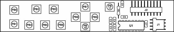

Pushbutton Board For LCD DisplayPJRC discontinued this product in February 2009, and has not sold these LCDs since that time. PJRC has never sold this LCD via eBay.This pushbutton adaptor board connects the JW-002 Display to the MP3 player. An EPROM or Flash ROM, programmed with LCD.HEX, must be placed in the firmware socket on the JW-002 display board. LCD.HEX is built from JW002.ASM and four font description files, which are distributed within the source code on the firmware download page. A ready to use display package is available from PJRC. This package includes the JW-002 display with a properly programmed firmware chip installed, the assembled pushbutton adaptor board, a ribbon cable to connect the JW-002 to this pushbutton board, and a 4 pin cable to connect the pushbutton board to the MP3 player. The information on this page is intended for those who want to understand how the pushbutton board works, make modifications, or build their own. A MAX232 chip converts the serial port signal polarity and levels. The negative voltage generated by the MAX232 charge pump is used to drive the LCD's -Vee input. Twelve pushbuttons are connected in a 4x3 matrix and are scanned by the firmware running on the display. A simple R-C delay provides a reset signal to the reset circuitry on the JW-002 display. Schematic DiagramParts List

Component PlacementAbout the JW-002 DisplayThe JW-002 display was originally used in an AT&T terminal of some sort, and many more displays were made than were ultimately used. These displays are available as a surplus item from Earth Computer Tech. They have a page with more information about this display, including a pinout of the 17 pin connector.The JW-002 firmware socket is wired for the standard 32 pin pinout (not the 28 pin arrangement found on a 27C512 chip), so only chips which use the 32 pin pinout will work in the socket. PJRC does not have a schematic for the JW-002 display. Some information about the circuitry, discovered by reverse engineering, can be found in the comments of JW002.ASM within the firmware source code. If you wish to develop your own applications using this display, that source code is all the information that PJRC can provide for you. Be sure to download the latest code from CVS, as older versions had bugs due to minor misunderstanding from incomplete information in the initial round of reverse engineering. Earth's web page has a "Coming Soon" section, where a schematic and other detailed information may someday appear. Earth may have had an engineer begin a reverse engineering effort at one time, but when we contacted them early in 2001, they had no information. All of the code in JW002.ASM was written based on reverse engineering done by Paul Stoffregen/PJRC and has been tested on many display boards (but of course the code comes with no warrant, just like all other software, free or expensive alike). We have shared our source code with Earth, and it is available for you to download and use as well.
