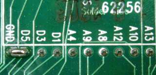

When the memory editor is first entered, nothing initially appears to be wrong. Perhaps some people could notice that none of these 256 bytes has its D5 bit set? Because nearly all problems are observed by noticing the difference between an expected change in the display and the actual change that takes place, this page includes the initial display in each of these examples.
Usually, the first step is to press CTRL-E to enable editing, and then type several bytes to begin testing the memory. On the examples for this page, the pattern "0102040810204080" was typed. This enters 8 bytes where each has one bit set. Entering 00, FF, and 8 more with all but one bit set can also be helpful. In this case, the error is easy to see:
The byte at position 2005 is 00, when it should have been 20. Looking at these images does not have the visual impact that you get the instant your finger strikes that '0' key, and rather than "20" appearing, you see "00". In this case, it is very quick and easy to see the error and deduce that the D5 bit is not working properly. Note: all data line problems are also effectively address line problems because of the multiplexed bus design. In this section, we have ignored this effect for the sake of simplicity. See case #3. Case 2: Data Lines Shorted TogetherThis second example is very similar to the first one, but two data lines are shorted together.

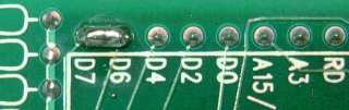

Again, when viewing the initial screen, it's not immediately obvious that all these bytes have their D6 and D7 bits the same.
As before, once you start editing, the problem turns up quickly. Here, CTRL-E was pressed to allow editing, and "0102040810204080" was typed to enter 8 test bytes.
At location 2006, the incorrect "C0" is seen rather than "40", and the same occurs at 2007 rather than "80". In each of these cases, one line is driving low and the other high. By chance, both bits ended up being written as 1s to the memory, and then read back as 1s. The bits read back could be either both zero or both one. In this case, they were both one. If they had happened to be both zero, you might at first believe both D6 and D7 were stuck at zero. Using more tests with 00, FF, FE, FD, FB, F7, EF, DF, BF and 7F would quickly reveal that those two bits were not stuck at a particular value. Usually, the 8 simple cases with only 1 bit set are enough to quickly discover a problem, but if the error is not clear, trying 00, FF and the 8 bytes with only all but one bit set to 1 help provide more information. Note: all data line problems are also effectively address line problems because of the multiplexed bus design. In this section, we have ignored this effect for the sake of simplicity. See case #3. Case 3: Lower Address Line Stuck At ZeroNow, let's look at the more difficult case where an address line is not connected properly. This can also easily be detected using the memory editor, but the technique is different.

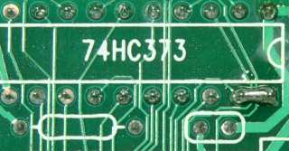

As usual, the initial memory editor screen does not make the problem obvious, though someone very observant might notice that groups of bytes are duplicated. Rarely is your time well spent staring at the initial display, because the problem will become very obvious as you interact with the memory.
As before, CTRL-E is pressed to enable editing, and the "0102040810204080" is typed to enter the basic 8 byte test pattern that worked so well in the previous two examples.
After entering the 8 bytes, the memory appears to be working perfectly. This is because each on-screen byte is the result of reading back only that byte after having written it. The other 255 bytes remain the same on-screen, because they are being held in the buffer of your PC's terminal emulator. Those other 255 bytes are old information stored on your PC, not the current state of the circuit board's observable memory. The next step is to press CTRL-L. For simplicity, this was not mentioned in the previous 2 examples. However, you should ALWAYS try pressing CTRL-L. Normally, nothing should change. When bytes change unexpectedly, you immediately know something is wrong, and that something is typically an error on the lower 8 address lines.
In this example, the bytes from 2008 to 200F unexpectedly change when CTRL-L is pressed. We know that this is because the A3 line is stuck at zero, as shown in figure 3. Deducing which address lines are bad can be tricky, especially when the error is a more difficult open-circuit that can fail as a 1 or 0 (and may change between attempts, or may be different depending on what data was previously transfered). Luckily, there are only 8 address lines to check when you see bytes mysteriously change after a CTRL-L. Warning: many multimeters output a large test current when used on their lower resistance measurement ranges, or their continuity (beeper) mode. If this test current flows through the static discharge protection diodes on a chip, that pin or the entire chip can be damaged. Check your multimeter's current level, and to be cautious, disable auto-ranging to force it to only output a safe current (less than 20 µA) for probing connectivity on the board while chips are installed in their sockets. Case 4: Upper Address Line Stuck At ZeroIn this example, A11 is shorted to ground. Sorry, no photo this time.Because the memory editor shows only 256 bytes at a time, it really isn't very useful for dianosing this type of problem. All the steps shown above will indicate that the memory is functioning properly. Fortunately, this type of problem is easy to see by just download blink_ram.hex. Everything appears normal at first:

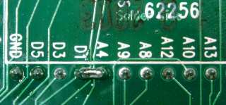

In this case, a data line is shorted to an address line. As a result, we'll likely see both types of behavior. Unlike the previous cases, this initial memory editor screen "looks funny". There are several unlikely, visually recognizable patterns. But as before, guessing based on the initial display is difficult and observing behavior during editing is easy.
As usual, CTRL-E was pressed, and then "0102040810204080" was typed to do the simple 8 byte test.
The error at 2001 is immediately obvious, it's almost impossible not to see it when you are actually typing. At first, this appears to be the D1 line stuck at zero, as in case #1. CTRL-L should always be used as a quick check for the address lines. The following appears once CTRL-L is pressed.
It's immediately obvious something is wrong with one of the lower address lines, because bytes change unexpectedly upon pressing CTRL-L. But this display would lead you to believe that A1 is stuck, because the pattern repeats ever 2nd byte. In fact, the A1 signal is latched from the D1 signal by the 74HC373. So errors on D1 will cause A1 to be incorrect. Because of this dependance of the address bits on the data lines, the best troubleshooting strategy when mulitple problems are present is to fix the easier data bit problems first, then concentrate on the address bits once the data bits are working properly. Case 6: Wrong Chip SelectedMost of the signals are address and data lines, so an error at some random position on the board is most likely to impact address or data bits. However, all the memory devices require chip select and control signals, which can also have problems.This example shows an unlikely problem with chip selects, and also serves to illustrate some properties of the 82C55 peripheral chip.

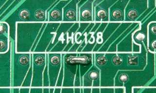

In this sample, the error is a short between pins 4 and 5 of the 74HC138 chip, which forces the output of a 74AC20 gate to zero. The result is the flash rom never gets a chip select signal, and instead the 74HC138 chip always attempts to select a peripheral over the range 0x8000 to 0xFFFF, rather than 0xF800 to 0xFFFF. Before attempting the memory editor, you should notice the following when downloading the three sample files, leading you to believe the RAM and 82C55 (and all connections) are working properly, but you may have a defective flash rom chip. blink_ram.hex: downloads without errors and runs without problems. blink_82c55.hex: downloads correctly and LEDs respond properly. blink_flash.hex: does not download correctly, and strange problems result. When downloading to the flash, it will seem the flash is partially working but not storing data reliably. Each download attempt can produce slighly different results. If you try this with the flash chip removed, the same thing happens, which is very mysterious.
When you run the memory editor to begin investigating the problems with the flash rom, unlike usual, the initial screen gives the immediate impression that something is very wrong. It seems as if all the address bits except for A0 and A1 are not working.
If you try editing this, you will find that locations F000, F001 and F002 appear to be working memory, but F003 does not. If you press CTRL-L before editing F003, your impression that only A0 and A1 is reinforced because the whole screen changes. If you edit F003 (which does not read back correctly) and then press CTRL-L, all the bytes change to zero. This is the correct behavior of the 82C55 peripheral chip. The "+3" location is the write-only configuration register. When it is written, the 82C55 chip clears the other three registers to zero. The other 3 bytes are read/write registers that control ports A, B and C. The important point is to recognize that memory mapped peripheral chips like the 82C55 have very unusual behavior when you are expecting ordinary memory. These chips usually only have a small group of registers (4 in the 82C55), so they appear repeated over and over again in memory. This is not bad address bits. Recognizing this behavior as the 82C55 chip is the critical step that will lead you to troubleshoot the address decoding logic. It appears at first that the flash chip is defective, but in fact it is most likely perfectly fine, but not actually being used because of an error in the chip selection based on the address bits. Case 7: No Chip SelectedOne final case to be aware of is the circumstance where no chip is responding. This is easy to recognize, because each byte reads the same as its lower 8 address bits, and all attempts to write have no effect.When you see this in the memory editor, and all attempts to edit have no effect, there is probably no chip being selected.
You might expect to see all bytes with the same value, but that is not the way the hardware works. Because of the multiplexing of the lower 8 address bits with the data lines, the 8051 drives the data bus with the lower half of the address. Then when it reads the bus less than one microsecond later, the lines are "floating", with their capacitance charged (or discharged) to the same voltage that was used during the address output to the 74HC373. The result is the display you see here. Recognizing this condition can help you quickly know what is (or isn't) wrong when you see it. No (or very few) Easy AnswersTroubleshooting memory problems is frustrating. There are no simple, easy tests that quickly diagnose all types of problems.By downloading to each type of memory, both with and without the other memory chips installed, you can get some initial impressions about whether the chips are working. But as the chip select example (case 6) shows, even that simple technique can be deceptive. Most memory errors are easy to spot in the memory editor once you start writing to the memory. Pressing CTRL-L to refresh the screen is a critically important step, because address line problems manifest themselves as other related locations unexpectedly changing. Data line problems cause address problems due to the mulitplexed bus, so simpler data bit problems should be solved first before address lines. Reversing the process shown here, where you can see the incorrect behavior and need to deduce the hardware cause requires good knowledge of the schematic, strong deductive reasoning, and sometimes dumb luck. Often, after staring at the incorrect on-screen performance, taking a break or even "sleeping on it" can help give you a fresh perspective to recognize what it really means. Hopefully this page has at least illustrated the process (if in reverse) and shown some of the more common problems. Technical SupportPJRC does not provide technical support for boards built using components purchased from other companies. The text of this page is the only assistance available if your board is hand wired on a breadboard, or using point to point solder or wire-wrap construction.However, if you built a board from the unassembled kit and it has memory access problems, perhaps we can help. Usually there is a fee for repair to boards build from kits, but it is much less expensive than buying a whole new board. All assembled and tested boards sold by PJRC should not have memory problems. Assembled boards (with the green dot on the serial port) are fully tested and the circuitry is known to be good before they are shipped. Damaged boards can be repaired simply by replacing the chips. Difficult memory editor techniques are rarely needed for the assembled boards. |
