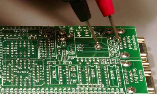

The serial port connector and 87C52 pins can only be measured from the bottom side of the board. Figures 2 and 3 show how to measure these. Pins on the 74HC02 and MAX232 chip can be measured from either side. When measuring from the bottom, remember that the order is reversed. Pin 1 is indicated by a square solder pad to help you correctly identify the pins.
