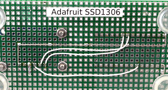

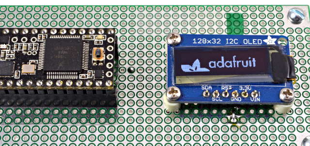

Adafruit SSD1306 OLED LibraryThis library supports the Small OLED displays sold by Adafruit Industries.Download: Adafruit_SSD1306.zip Hardware RequirementsAdafruit sells these OLED displays in I2C and SPI interface.
See below for the reverse-side wiring. 32 vs 64 Pixel HeightYou may need to edit Adafruit_SSD1306.h to set the display height.Look for this code and uncomment either 64 or 32 pixel height.

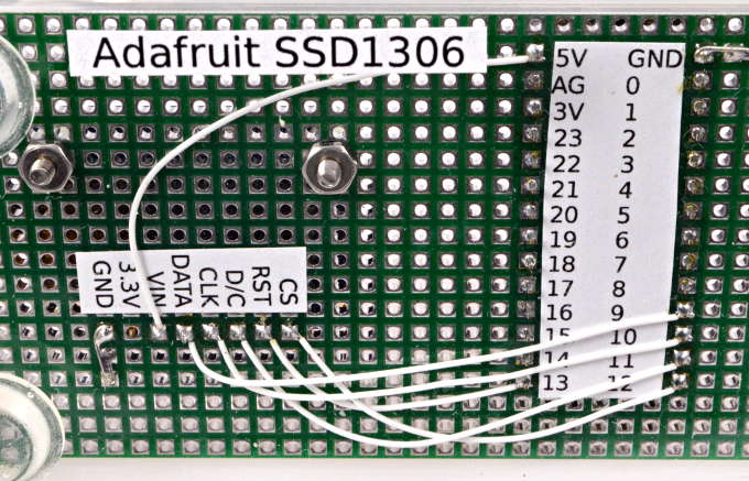

/*========================================================================= SSD1306 Displays ----------------------------------------------------------------------- The driver is used in multiple displays (128x64, 128x32, etc.). Select the appropriate display below to create an appropriately sized framebuffer, etc. SSD1306_128_64 128x64 pixel display SSD1306_128_32 128x32 pixel display -----------------------------------------------------------------------*/ // #define SSD1306_128_64 #define SSD1306_128_32 /*=========================================================================*/ Example ProgramThis example program comes with the library. You can open it from the File -> Examples -> Adafruit_SSD1306 -> ssd1306_128x32_spi menu.
/********************************************************************* This is an example for our Monochrome OLEDs based on SSD1306 drivers Pick one up today in the adafruit shop! ------> http://www.adafruit.com/category/63_98 This example is for a 128x32 size display using SPI to communicate 4 or 5 pins are required to interface Adafruit invests time and resources providing this open source code, please support Adafruit and open-source hardware by purchasing products from Adafruit! Written by Limor Fried/Ladyada for Adafruit Industries. BSD license, check license.txt for more information All text above, and the splash screen must be included in any redistribution *********************************************************************/ #include <SPI.h> #include <Wire.h> #include <Adafruit_GFX.h> #include <Adafruit_SSD1306.h> // If using software SPI (the default case): #define OLED_MOSI 9 #define OLED_CLK 10 #define OLED_DC 11 #define OLED_CS 12 #define OLED_RESET 13 Adafruit_SSD1306 display(OLED_MOSI, OLED_CLK, OLED_DC, OLED_RESET, OLED_CS); /* Uncomment this block to use hardware SPI #define OLED_DC 6 #define OLED_CS 7 #define OLED_RESET 8 Adafruit_SSD1306 display(OLED_DC, OLED_RESET, OLED_CS); */ #define NUMFLAKES 10 #define XPOS 0 #define YPOS 1 #define DELTAY 2 #define LOGO16_GLCD_HEIGHT 16 #define LOGO16_GLCD_WIDTH 16 static const unsigned char PROGMEM logo16_glcd_bmp[] = { B00000000, B11000000, B00000001, B11000000, B00000001, B11000000, B00000011, B11100000, B11110011, B11100000, B11111110, B11111000, B01111110, B11111111, B00110011, B10011111, B00011111, B11111100, B00001101, B01110000, B00011011, B10100000, B00111111, B11100000, B00111111, B11110000, B01111100, B11110000, B01110000, B01110000, B00000000, B00110000 }; #if (SSD1306_LCDHEIGHT != 32) #error("Height incorrect, please fix Adafruit_SSD1306.h!"); #endif void setup() { Serial.begin(9600); // by default, we'll generate the high voltage from the 3.3v line internally! (neat!) display.begin(SSD1306_SWITCHCAPVCC); // init done display.display(); // show splashscreen delay(2000); display.clearDisplay(); // clears the screen and buffer // draw a single pixel display.drawPixel(10, 10, WHITE); display.display(); delay(2000); display.clearDisplay(); // draw many lines testdrawline(); display.display(); delay(2000); display.clearDisplay(); // draw rectangles testdrawrect(); display.display(); delay(2000); display.clearDisplay(); // draw multiple rectangles testfillrect(); display.display(); delay(2000); display.clearDisplay(); // draw mulitple circles testdrawcircle(); display.display(); delay(2000); display.clearDisplay(); // draw a white circle, 10 pixel radius display.fillCircle(display.width()/2, display.height()/2, 10, WHITE); display.display(); delay(2000); display.clearDisplay(); testdrawroundrect(); delay(2000); display.clearDisplay(); testfillroundrect(); delay(2000); display.clearDisplay(); testdrawtriangle(); delay(2000); display.clearDisplay(); testfilltriangle(); delay(2000); display.clearDisplay(); // draw the first ~12 characters in the font testdrawchar(); display.display(); delay(2000); display.clearDisplay(); // draw scrolling text testscrolltext(); delay(2000); display.clearDisplay(); // text display tests display.setTextSize(1); display.setTextColor(WHITE); display.setCursor(0,0); display.println("Hello, world!"); display.setTextColor(BLACK, WHITE); // 'inverted' text display.println(3.141592); display.setTextSize(2); display.setTextColor(WHITE); display.print("0x"); display.println(0xDEADBEEF, HEX); display.display(); delay(2000); // miniature bitmap display display.clearDisplay(); display.drawBitmap(30, 16, logo16_glcd_bmp, 16, 16, 1); display.display(); // invert the display display.invertDisplay(true); delay(1000); display.invertDisplay(false); delay(1000); // draw a bitmap icon and 'animate' movement testdrawbitmap(logo16_glcd_bmp, LOGO16_GLCD_HEIGHT, LOGO16_GLCD_WIDTH); } void loop() { } void testdrawbitmap(const uint8_t *bitmap, uint8_t w, uint8_t h) { uint8_t icons[NUMFLAKES][3]; // initialize for (uint8_t f=0; f< NUMFLAKES; f++) { icons[f][XPOS] = random(display.width()); icons[f][YPOS] = 0; icons[f][DELTAY] = random(5) + 1; Serial.print("x: "); Serial.print(icons[f][XPOS], DEC); Serial.print(" y: "); Serial.print(icons[f][YPOS], DEC); Serial.print(" dy: "); Serial.println(icons[f][DELTAY], DEC); } while (1) { // draw each icon for (uint8_t f=0; f< NUMFLAKES; f++) { display.drawBitmap(icons[f][XPOS], icons[f][YPOS], logo16_glcd_bmp, w, h, WHITE); } display.display(); delay(200); // then erase it + move it for (uint8_t f=0; f< NUMFLAKES; f++) { display.drawBitmap(icons[f][XPOS], icons[f][YPOS], logo16_glcd_bmp, w, h, BLACK); // move it icons[f][YPOS] += icons[f][DELTAY]; // if its gone, reinit if (icons[f][YPOS] > display.height()) { icons[f][XPOS] = random(display.width()); icons[f][YPOS] = 0; icons[f][DELTAY] = random(5) + 1; } } } } void testdrawchar(void) { display.setTextSize(1); display.setTextColor(WHITE); display.setCursor(0,0); for (uint8_t i=0; i < 168; i++) { if (i == '\n') continue; display.write(i); if ((i > 0) && (i % 21 == 0)) display.println(); } display.display(); } void testdrawcircle(void) { for (int16_t i=0; i<display.height(); i+=2) { display.drawCircle(display.width()/2, display.height()/2, i, WHITE); display.display(); } } void testfillrect(void) { uint8_t color = 1; for (int16_t i=0; i<display.height()/2; i+=3) { // alternate colors display.fillRect(i, i, display.width()-i*2, display.height()-i*2, color%2); display.display(); color++; } } void testdrawtriangle(void) { for (int16_t i=0; i<min(display.width(),display.height())/2; i+=5) { display.drawTriangle(display.width()/2, display.height()/2-i, display.width()/2-i, display.height()/2+i, display.width()/2+i, display.height()/2+i, WHITE); display.display(); } } void testfilltriangle(void) { uint8_t color = WHITE; for (int16_t i=min(display.width(),display.height())/2; i>0; i-=5) { display.fillTriangle(display.width()/2, display.height()/2-i, display.width()/2-i, display.height()/2+i, display.width()/2+i, display.height()/2+i, WHITE); if (color == WHITE) color = BLACK; else color = WHITE; display.display(); } } void testdrawroundrect(void) { for (int16_t i=0; i<display.height()/2-2; i+=2) { display.drawRoundRect(i, i, display.width()-2*i, display.height()-2*i, display.height()/4, WHITE); display.display(); } } void testfillroundrect(void) { uint8_t color = WHITE; for (int16_t i=0; i<display.height()/2-2; i+=2) { display.fillRoundRect(i, i, display.width()-2*i, display.height()-2*i, display.height()/4, color); if (color == WHITE) color = BLACK; else color = WHITE; display.display(); } } void testdrawrect(void) { for (int16_t i=0; i<display.height()/2; i+=2) { display.drawRect(i, i, display.width()-2*i, display.height()-2*i, WHITE); display.display(); } } void testdrawline() { for (int16_t i=0; i<display.width(); i+=4) { display.drawLine(0, 0, i, display.height()-1, WHITE); display.display(); } for (int16_t i=0; i<display.height(); i+=4) { display.drawLine(0, 0, display.width()-1, i, WHITE); display.display(); } delay(250); display.clearDisplay(); for (int16_t i=0; i<display.width(); i+=4) { display.drawLine(0, display.height()-1, i, 0, WHITE); display.display(); } for (int16_t i=display.height()-1; i>=0; i-=4) { display.drawLine(0, display.height()-1, display.width()-1, i, WHITE); display.display(); } delay(250); display.clearDisplay(); for (int16_t i=display.width()-1; i>=0; i-=4) { display.drawLine(display.width()-1, display.height()-1, i, 0, WHITE); display.display(); } for (int16_t i=display.height()-1; i>=0; i-=4) { display.drawLine(display.width()-1, display.height()-1, 0, i, WHITE); display.display(); } delay(250); display.clearDisplay(); for (int16_t i=0; i<display.height(); i+=4) { display.drawLine(display.width()-1, 0, 0, i, WHITE); display.display(); } for (int16_t i=0; i<display.width(); i+=4) { display.drawLine(display.width()-1, 0, i, display.height()-1, WHITE); display.display(); } delay(250); } void testscrolltext(void) { display.setTextSize(2); display.setTextColor(WHITE); display.setCursor(10,0); display.clearDisplay(); display.println("scroll"); display.display(); display.startscrollright(0x00, 0x0F); delay(2000); display.stopscroll(); delay(1000); display.startscrollleft(0x00, 0x0F); delay(2000); display.stopscroll(); delay(1000); display.startscrolldiagright(0x00, 0x07); delay(2000); display.startscrolldiagleft(0x00, 0x07); delay(2000); display.stopscroll(); } Wiring on Back Side of Boards
