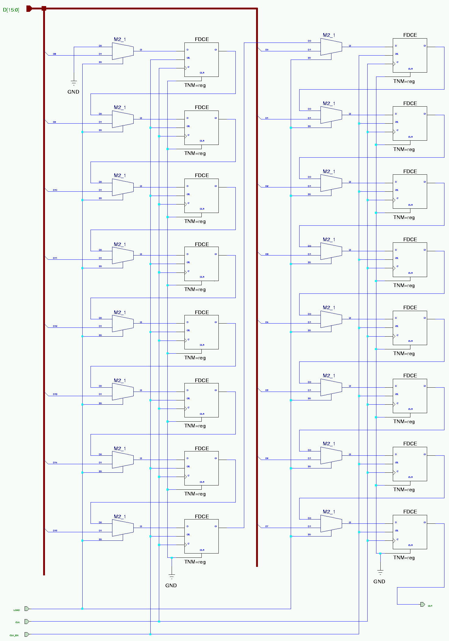

  6. MP3 Output Shift Register 1.10 (62k) - 16 bit shift register that captures a 16-bit word from the IDE interface and shifts it to the STA013 MP3 decoder.

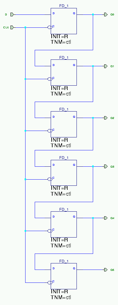

  21. Shift Register, 6 Bits 1.10 (8k) - Used in state machine. Avoids Aldec crash.

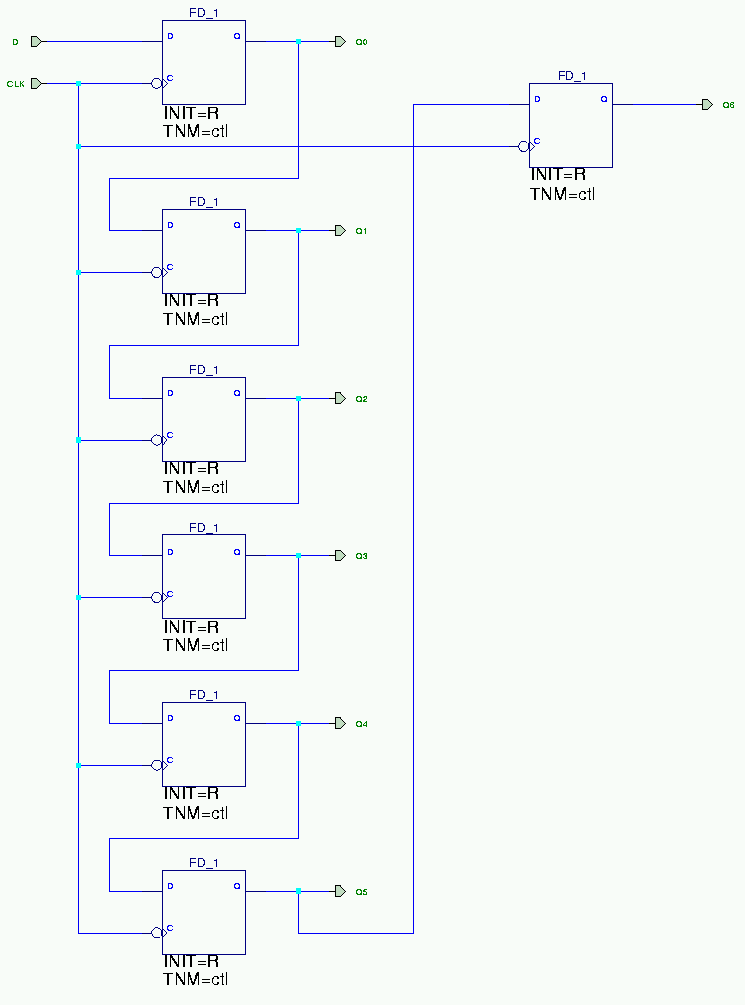

  22. Shift Register, 7 Bits 1.10 (10k) - Used in state machine. Avoids Aldec crash.

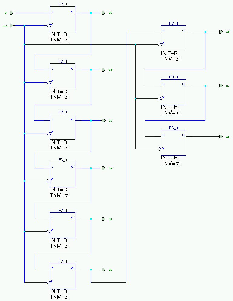

  23. Shift Register, 9 Bits 1.10 (13k) - Used in state machine. Avoids Aldec crash. Did I mention yet how buggy Aldec is??
