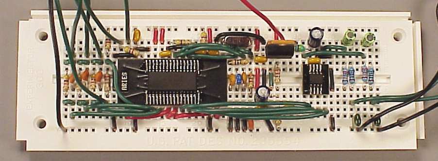

Connecting The Chip
The first problem with using the STA013 for a prototype MP3 player is that it is a surface mount part. Unfortunately, it is not made in any through-hole packages. The two basic approaches are to buy or make an adaptor board, or to solder wires to each pin.
STA013 Chip and Aries Adaptor
Figure 2: STA013 Chip and Aries SOP to DIP Adaptor Board
Aries makes adaptors that are ideal for connecting the STA013 in a prototype, which DIP pins are easier to use. The adaptor shown in Figure 2 is available at DigiKey (P/N: A323-ND). This is actually a 32 pin adaptor, so 4 pins are unused with the 28 pin STA013. While an adaptor circuit board is easier, it is also possible to solder wires to all the pins. Here's a student project by Peter D'Antonio and Danial Riiff, with 28 wires soldered.

STA013/CS4334 Schematic
Figure 6: Typical Connection of STA013 and CS4334
The resistors connected to PVDD and PVSS are 4.7 Ohm (not 4.7k). Any value near a few ohms is ok, if 4.7 ohms is not available. The capacitors connected to the crystal may need to be changed to match the resonance of the crystal. Values are usually in the range of 15 to 47 pF, and many crystals are not very sensitive to the exact capacitor values used. The inductor shown on the CS4334 power supply is intended to block noise from digital circuitry that's also connected to that line. The value of the inductor is not critical, so 100 µH would probably work well. In no inductor is available, and alternative is to create a separate ("clean") supply for the CS4334 with a LM7805 or similar linear-mode voltage regulator.
From Deckx Kevin:
Because of the way your circuit is drawn it's very easy to switch up pin 17 and 18 and cause a 9-10 ohm resistance path from Vcc to the ground. My sta013 only survived because of current limiting around 100mA.

Simple Example System
TODO: draw schematic that exactly matches breadboard wiring... very similar to figure 6, add LM317 and 3/5 volt interface parts (figures 3,4,5), re-label I/O with 8051 port pin names. For now, check the ASM source comments for which port pins connect to what signals.
TODO: write some descriptive text... the pictures show what it looks like and the screen dumps shown how to run with PM2 monitor. See comments in the code for making a stand-alone version or using with a different development system.
Example Breadboard Wiring
Here's a typical session using the example code. The code is written to run with the PM2 monitor program. It can be easily modified to run under a different development system, or stand-alone. See the comments in the source code for details. The example uses the 8051 development board.
