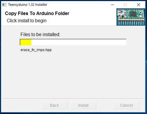

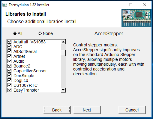

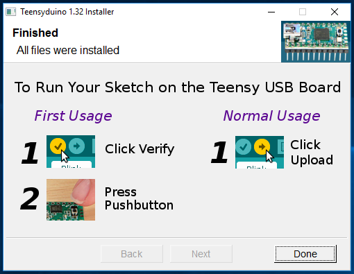

  2. Download and run the Teensyduino installer.

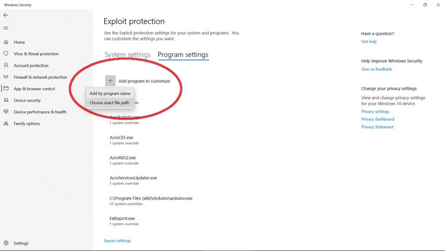

  3. (optional) Check for anti-virus performance problems.

  6. (optional) Check for anti-virus performance problems.
