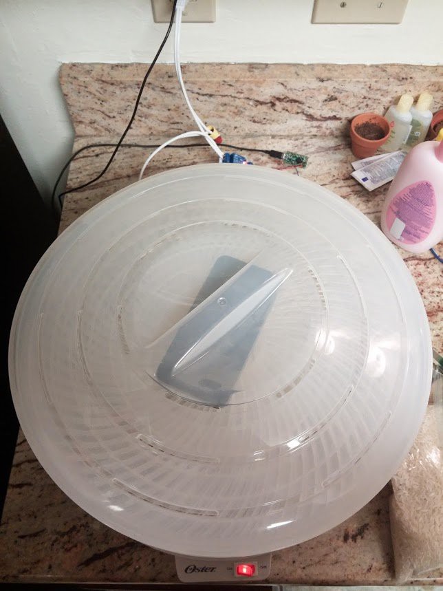

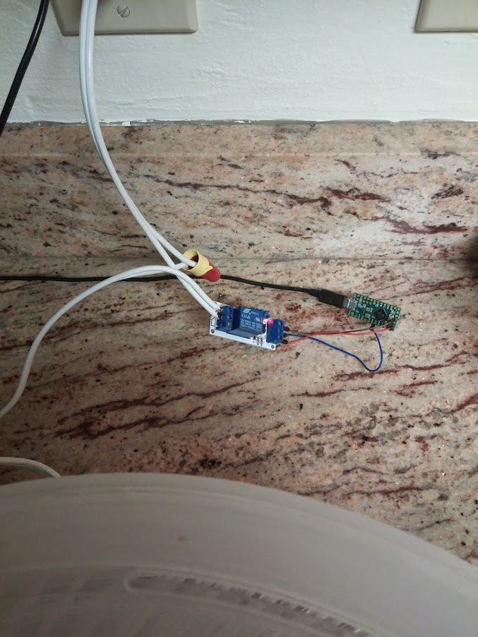

Wet iPhone Fix
deeproot2k rescued a wet iPhone with in impromptu hack of his food dehydrator with a Teensy-LC
After the iPhone was dropped in a sink an attempt was made to dry it out in a bag of rice.  The results weren’t great so plan b was to dry it out with a food dehydrator.  Because the dehydrator gets too hot for the iPhone, a Teensy-LC was hooked up to a relay connected to the dehydrator to turn it on for 5 minutes and off for 15 minutes for a total of about 3 hours.  The end result – a working iPhone.
