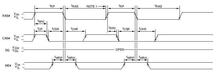

CBR REFRESH CYCLE 25 (Addresses = DON'T CARE)
FAST PAGE MODE AND EDO PAGE MODE TIMING PARAMETERS
                                                    -5*                                      -6                                                                                   -5*                                 -6
   SYMBOL                                  MIN              MAX                      MIN            MAX        UNITS               SYMBOL                                MIN              MAX               MIN                MAX           UNITS
   t                                                                                                                               t
   ASR                                         0                                      0                          ns                     RC (FPM)                           ­                                110                                 ns
   t                                                                                                                               t
   CHR (FPM)                                   ­                                      10                         ns                     RC (EDO)                          84                                104                                 ns
   t                                                                                                                               t
   CHR (EDO)                                   8                                      10                         ns                     RP                                30                                 40                                 ns
   t                                                                                                                               t
   CP                                          8                                      10                         ns                     RPC (FPM)                          ­                                 0                                  ns
   t                                                                                                                               t
   CRP                                         5                                      5                          ns                     RPC (EDO)                          5                                 5                                  ns
   t                                                                                                                               t
   CSR                                         5                                      5                          ns                     WRH                                8                                 10                                 ns
   t                                                                                                                               t
   RAH                                         9                                      10                         ns                     WRP                                8                                 10                                 ns
   tRAS                                    50              10,000                     60           10,000        ns
*EDO version only
