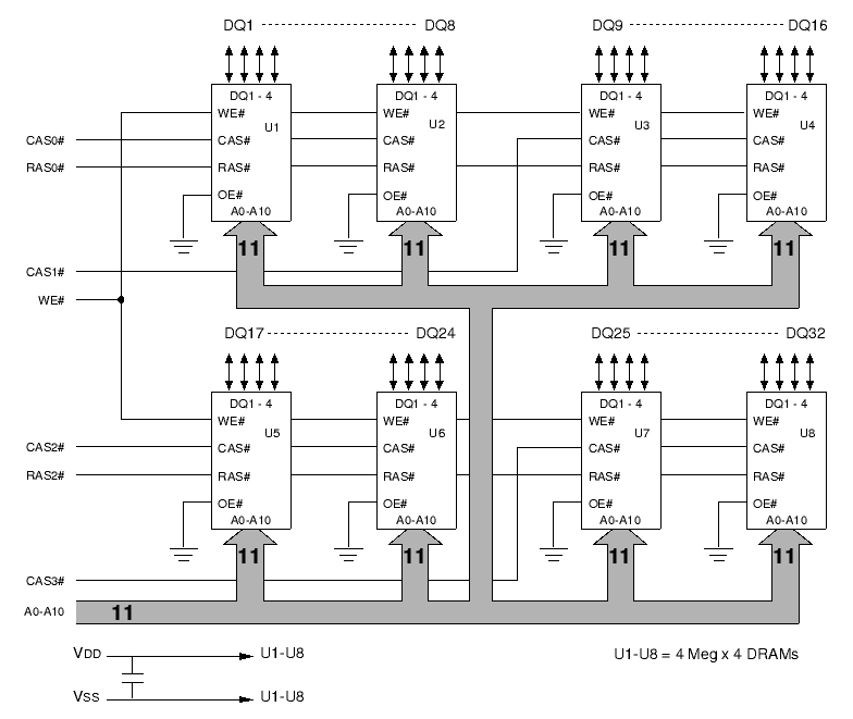

JEDEC-DEFINED PRESENCE-DETECT MT8D432(X) (16MB) SYMBOL PIN -5* -6 PRD1 67 VSS VSS PRD2 68 NC NC PRD3 69 VSS NC PRD4 70 VSS NC JEDEC-DEFINED PRESENCE-DETECT MT16D832(X) (32MB) SYMBOL PIN -5* -6 PRD1 67 NC NC PRD2 68 VSS VSS PRD3 69 VSS NC PRD4 70 VSS NC *EDO version only FUNCTIONAL BLOCK DIAGRAM, MT8D432(X) (16MB)FUNCTIONAL BLOCK DIAGRAM, MT16D832(X) (32MB)ABSOLUTE MAXIMUM RATINGS*Voltage on Any Pin Relative to VSS .................. -1V to +7V Operating Temperature, TA (ambient) ............... 0°C to +70°C Storage Temperature (plastic)................... -55°C to +125°C Power Dissipation ........................................... 8W Short Circuit Output Current .............................. 50mA*Stresses greater than those listed under "Absolute Maximum Ratings" may cause permanent damage to the device. This is a stress rating only and functional operation of the device at these or any other conditions above those indicated in the operational sections of this specification is not implied. Exposure to absolute maximum rating conditions for extended periods may affect reliability. DC ELECTRICAL CHARACTERISTICS AND OPERATING CONDITIONS(Notes: 1) (VDD = +5V ±10%)

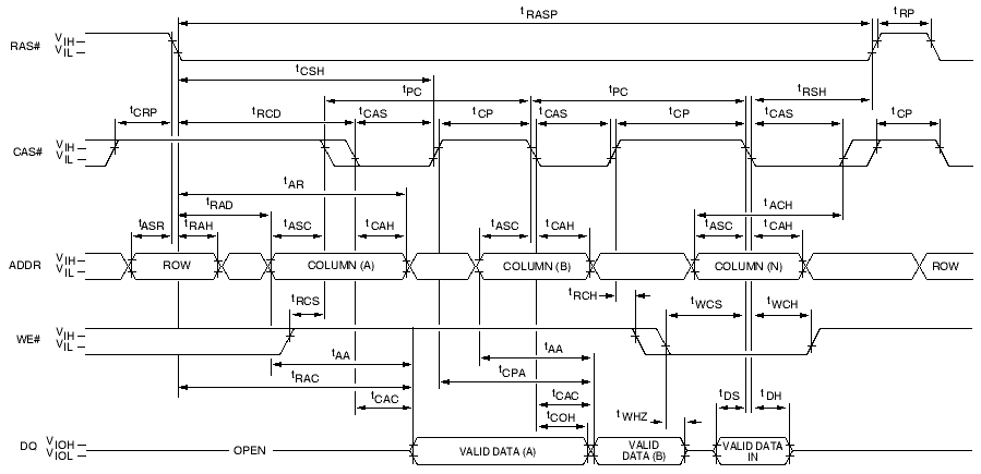

AC CHARACTERISTICS - EDO PAGE MODE OPTION -5 -6 PARAMETER SYMBOL MIN MAX MIN MAX UNITS NOTES Access time from column address tAA 25 30 ns Column-address set-up to CAS# precharge tACH 12 15 ns Column-address hold time (referenced to RAS#) tAR 38 45 ns Column-address setup time tASC 0 0 ns Row-address setup time tASR 0 0 ns Access time from CAS# tCAC 13 15 ns Column-address hold time tCAH 8 10 ns CAS# pulse width tCAS 8 10,000 10 10,000 ns CAS# hold time (CBR Refresh) tCHR 8 10 ns 4 CAS# to output in Low-Z tCLZ 0 0 ns Data output hold after next CAS# LOW tCOH 3 3 ns CAS# precharge time tCP 8 10 ns 13 Access time from CAS# precharge tCPA 28 35 ns CAS# to RAS# precharge time tCRP 5 5 ns CAS# hold time tCSH 38 45 ns CAS# setup time (CBR Refresh) tCSR 5 5 ns 4 WRITE command to CAS# lead time tCWL 8 10 ns Data-in hold time tDH 8 10 ns 18 Data-in setup time tDS 0 0 ns 18 Output buffer turn-off delay tOFF 0 12 0 15 ns 17, 21 EDO-PAGE-MODE READ or WRITE cycle time tPC 20 25 ns Access time from RAS# tRAC 50 60 ns RAS# to column-address delay time tRAD 9 12 ns 15 Row-address hold time tRAH 9 10 ns RAS# pulse width tRAS 50 10,000 60 10,000 ns RAS# pulse width (EDO PAGE MODE) tRASP 50 125,000 60 125,000 ns Random READ or WRITE cycle time tRC 84 104 ns RAS# to CAS# delay time tRCD 11 14 ns 14 READ command hold time (referenced to CAS#) tRCH 0 0 ns 16 READ command setup time tRCS 0 0 ns Refresh period (2,048 cycles) tREF 32 32 ms RAS# precharge time tRP 30 40 ns RAS# to CAS# precharge time tRPC 5 5 ns READ command hold time (referenced to RAS#) tRRH 0 0 ns 16 RAS# hold time tRSH 13 15 ns WRITE command to RAS# lead time tRWL 13 15 ns Transition time (rise or fall) tT 2 50 2 50 ns WRITE command hold time tWCH 8 10 ns WRITE command hold time (referenced to RAS#) tWCR 38 45 ns WE# command setup time tWCS 0 0 ns Output disable delay from WE# tWHZ 0 12 0 15 ns WRITE command pulse width tWP 5 5 ns WE# pulse to disable at CAS# HIGH tWPZ 10 10 ns WE# hold time (CBR Refresh) tWRH 8 10 ns WE# setup time (CBR Refresh) tWRP 8 10 ns NOTES

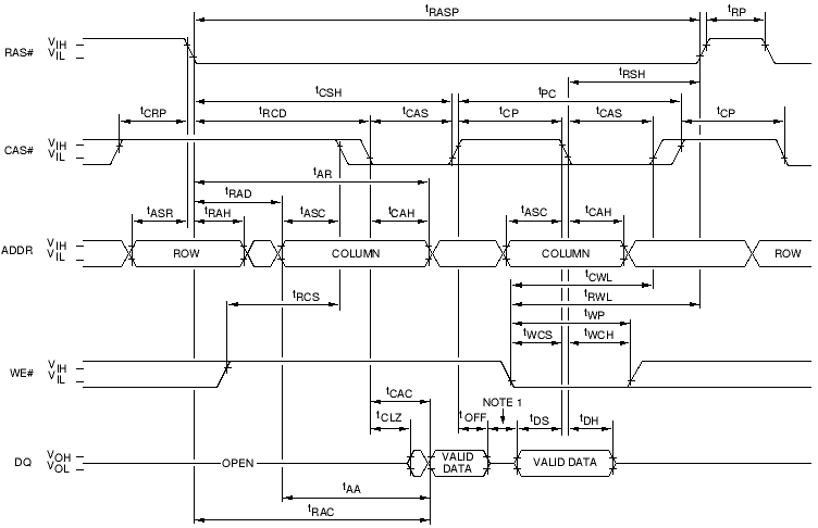

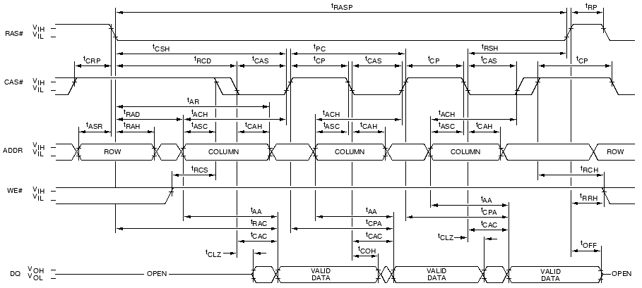

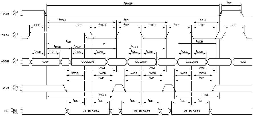

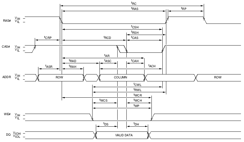

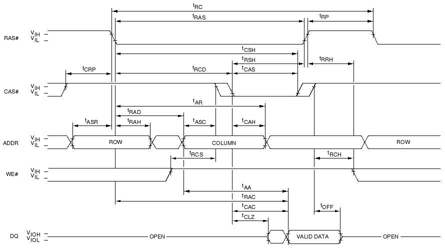

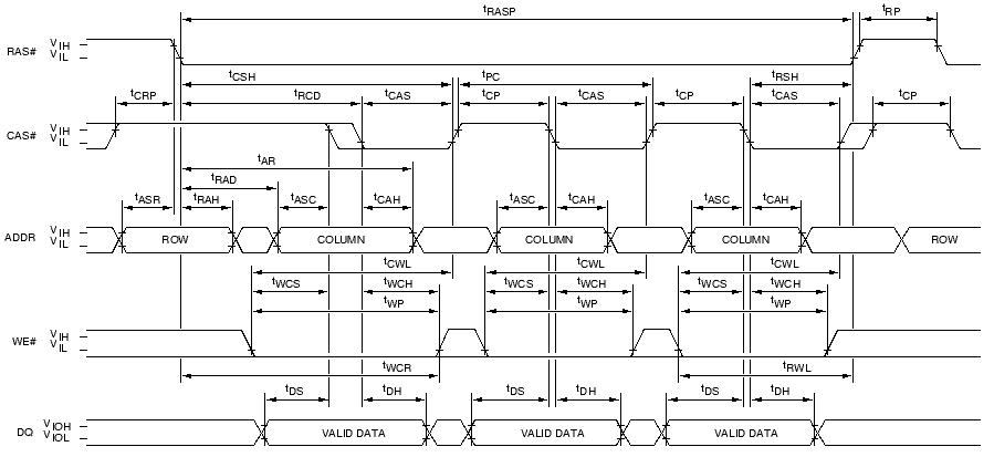

READ CYCLE (FAST PAGE MODE Module)FAST PAGE MODE TIMING PARAMETERS -6 -6 SYMBOL MIN MAX UNITS SYMBOL MIN MAX UNITS t t AA 30 ns RAC 60 ns t t AR 45 ns RAD 15 ns t t ASC 0 ns RAH 10 ns t t ASR 0 ns RAS 60 10,000 ns t t CAC 15 ns RC 110 ns t t CAH 10 ns RCD 20 ns t t CAS 15 10,000 ns RCH 0 ns t t CLZ 3 ns RCS 0 ns t t CRP 5 ns RP 40 ns t t CSH 60 ns RRH 0 ns t t OFF 3 15 ns RSH 15 ns READ CYCLE (EDO PAGE MODE Module)EDO PAGE MODE TIMING PARAMETERS -5 -6 -5 -6 SYMBOL MIN MAX MIN MAX UNITS SYMBOL MIN MAX MIN MAX UNITS tAA 25 30 ns tRAC 50 60 ns tAR 38 45 ns tRAD 9 12 ns tASC 0 0 ns tRAH 9 10 ns tASR 0 0 ns tRAS 50 10,000 60 10,000 ns tCAC 13 15 ns tRC 84 104 ns tCAH 8 10 ns tRCD 11 14 ns tCAS 8 10,000 10 10,000 ns tRCH 0 0 ns tCLZ 0 0 ns tRCS 0 0 ns tCRP 5 5 ns tRP 30 40 ns tCSH 38 45 ns tRRH 0 0 ns tOFF 0 12 0 15 ns tRSH 13 15 nsNOTE: 1. tOFF is referenced from rising edge of RAS# or CAS#, whichever occurs last. EARLY WRITE CYCLE25FAST PAGE MODE AND EDO PAGE MODE TIMING PARAMETERS -5* -6 -5* -6 SYMBOL MIN MAX MIN MAX UNITS SYMBOL MIN MAX MIN MAX UNITS t t ACH (EDO) 12 15 ns RAD (EDO) 9 12 ns t t AR 38 45 ns RAH 9 10 ns t t ASC 0 0 ns RAS 50 10,000 60 10,000 ns t t ASR 0 0 ns RC (FPM) 110 ns t t CAH 8 10 ns RC (EDO) 84 104 ns t t CAS (FPM) 15 10,000 ns RCD (FPM) 20 ns t t CAS (EDO) 8 10,000 10 10,000 ns RCD (EDO) 11 14 ns t t CRP 5 5 ns RP 30 40 ns t t CSH (FPM) 60 ns RSH 13 15 ns t t CSH (EDO) 38 45 ns RWL 13 15 ns t t CWL (FPM) 15 ns WCH 8 10 ns t t CWL (EDO) 8 10 ns WCR 38 45 ns t t DH 8 10 ns WCS 0 0 ns t t DS 0 0 ns WP (FPM) 10 ns t t RAD (FPM) 15 ns WP (EDO) 5 5 ns*EDO version only FAST-PAGE-MODE READ CYCLEFAST PAGE MODE TIMING PARAMETERS -6 -6 SYMBOL MIN MAX UNITS SYMBOL MIN MAX UNITS t t AA 30 ns OFF 3 15 ns t t AR 45 ns PC 35 ns t t ASC 0 ns RAC 60 ns t t ASR 0 ns RAD 15 ns t t CAC 15 ns RAH 10 ns t t CAH 10 ns RASP 60 125,000 ns t t CAS 15 10,000 ns RCD 20 ns t t CLZ 3 ns RCH 0 ns t t CP 10 ns RCS 0 ns t t CPA 35 ns RP 40 ns t t CRP 5 ns RRH 0 ns t t CSH 60 ns RSH 15 ns EDO-PAGE-MODE READ CYCLEEDO PAGE MODE TIMING PARAMETERS -5 -6 -5 -6 SYMBOL MIN MAX MIN MAX UNITS SYMBOL MIN MAX MIN MAX UNITS t t AA 25 30 ns CSH 38 45 ns t t ACH 12 15 ns OFF 0 12 0 15 ns t t AR 38 45 ns PC 20 25 ns t t ASC 0 0 ns RAC 50 60 ns t t ASR 0 0 ns RAD 9 12 ns t t CAC 13 15 ns RAH 9 10 ns t t CAH 8 10 ns RASP 50 125,000 60 125,000 ns t t CAS 8 10,000 10 10,000 ns RCD 11 14 ns t t CLZ 0 0 ns RCH 0 0 ns t t COH 3 3 ns RCS 0 0 ns t t CP 8 10 ns RP 30 40 ns t t CPA 28 35 ns RRH 0 0 ns t t CRP 5 5 ns RSH 13 15 ns FAST-PAGE-MODE EARLY-WRITE CYCLEFAST PAGE MODE TIMING PARAMETERS -6 -6 SYMBOL MIN MAX UNITS SYMBOL MIN MAX UNITS t t AR 45 ns RAD 15 ns t t ASC 0 ns RAH 10 ns t t ASR 0 ns RASP 60 125,000 ns t t CAH 10 ns RCD 20 ns t t CAS 15 10,000 ns RP 40 ns t t CP 10 ns RSH 15 ns t t CRP 5 ns RWL 15 ns t t CSH 60 ns WCH 10 ns t t CWL 15 ns WCR 45 ns t t DH 10 ns WCS 0 ns t t DS 0 ns WP 10 ns tPC 35 ns EDO-PAGE-MODE EARLY-WRITE CYCLEEDO PAGE MODE TIMING PARAMETERS -5 -6 -5 -6 SYMBOL MIN MAX MIN MAX UNITS SYMBOL MIN MAX MIN MAX UNITS t t ACH 12 15 ns PC 20 25 ns t t AR 38 45 ns RAD 9 12 ns t t ASC 0 0 ns RAH 9 10 ns t t ASR 0 0 ns RASP 50 125,000 60 125,000 ns t t CAH 8 10 ns RCD 11 14 ns t t CAS 8 10,000 10 10,000 ns RP 30 40 ns t t CP 8 10 ns RSH 13 15 ns t t CRP 5 5 ns RWL 13 15 ns t t CSH 38 45 ns WCH 8 10 ns t t CWL 8 10 ns WCR 38 45 ns t t DH 8 10 ns WCS 0 0 ns t t DS 0 0 ns WP 5 5 ns EDO-PAGE-MODE READ-EARLY-WRITE CYCLE (Pseudo READ-MODIFY-WRITE)EDO PAGE MODE TIMING PARAMETERS -5 -6 -5 -6 SYMBOL MIN MAX MIN MAX UNITS SYMBOL MIN MAX MIN MAX UNITS t t AA 25 30 ns DS 0 0 ns t t ACH 12 15 ns PC 20 25 ns t t AR 38 45 ns RAC 50 60 ns t t ASC 0 0 ns RAD 9 12 ns t t ASR 0 0 ns RAH 9 10 ns t t CAC 13 15 ns RASP 50 125,000 60 125,000 ns t t CAH 8 10 ns RCD 11 14 ns t t CAS 8 10,000 10 10,000 ns RCH 0 0 ns t t COH 3 3 ns RCS 0 0 ns t t CP 8 10 ns RP 30 40 ns t t CPA 28 35 ns RSH 13 15 ns t t CRP 5 5 ns WCH 8 10 ns t t CSH 38 45 ns WCS 0 0 ns t t DH 8 10 ns WHZ 0 12 0 15 ns FAST-PAGE-MODE READ-EARLY-WRITE CYCLE (Pseudo READ-MODIFY-WRITE)FAST PAGE MODE TIMING PARAMETERS -6 -6 SYMBOL MIN MAX UNITS SYMBOL MIN MAX UNITS t t AA 30 ns OFF 3 15 ns t t AR 45 ns PC 35 ns t t ASC 0 ns RAC 60 ns t t ASR 0 ns RAD 15 ns t t CAC 15 ns RAH 10 ns t t CAH 10 ns RASP 60 125,000 ns t t CAS 15 10,000 ns RCD 20 ns t t CLZ 3 ns RCS 0 ns t t CP 10 ns RP 40 ns t t CRP 5 ns RSH 15 ns t t CSH 60 ns RWL 15 ns t t CWL 15 ns WCH 10 ns t t DH 10 ns WCS 0 ns t t DS 0 ns WP 10 ns EDO READ CYCLE (with WE#-controlled disable)EDO PAGE MODE TIMING PARAMETERS -5 -6 -5 -6 SYMBOL MIN MAX MIN MAX UNITS SYMBOL MIN MAX MIN MAX UNITS tAA 25 30 ns tCSH 38 45 ns tAR 38 45 ns tRAC 50 60 ns tASC 0 0 ns tRAD 9 12 ns tASR 0 0 ns tRAH 9 10 ns tCAC 13 15 ns tRCD 11 14 ns tCAH 8 10 ns tRCH 0 0 ns tCAS 8 10,000 10 10,000 ns tRCS 0 0 ns tCLZ 0 0 ns tWHZ 0 12 0 15 ns tCP 8 10 ns tWPZ 10 10 ns tCRP 5 5 ns RAS#-ONLY REFRESH CYCLE 25

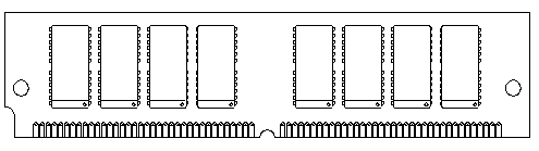

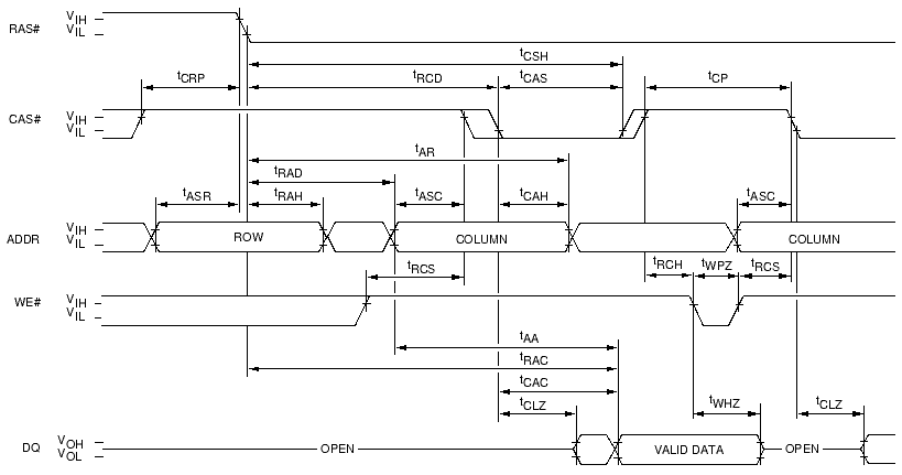

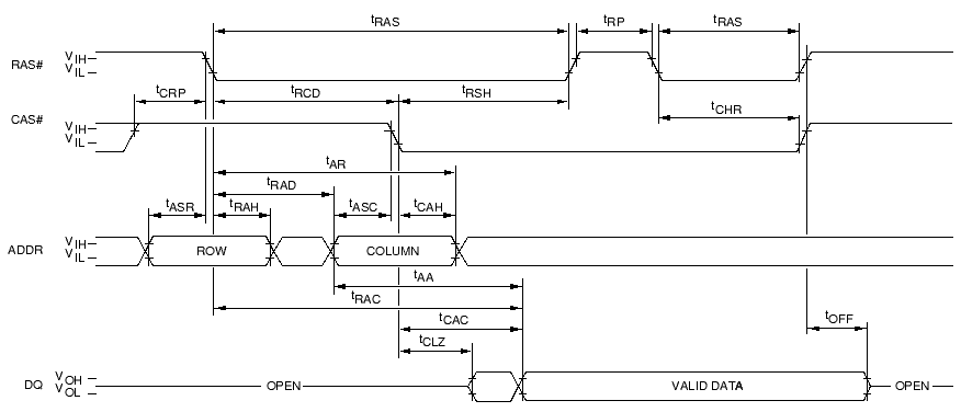

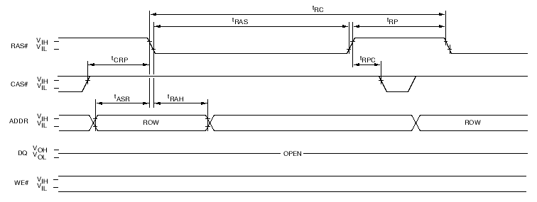

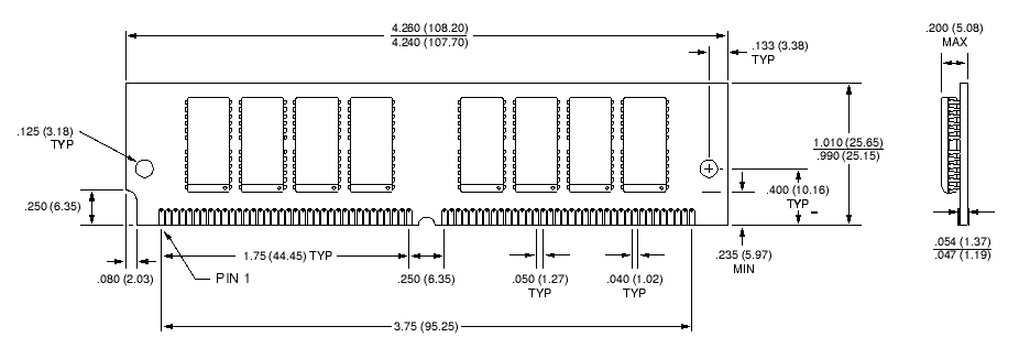

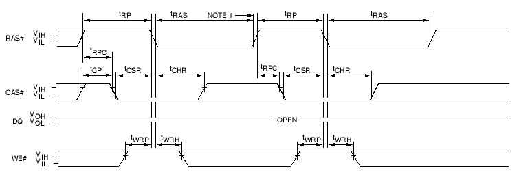

CBR REFRESH CYCLE 25 (Addresses = DON'T CARE)FAST PAGE MODE AND EDO PAGE MODE TIMING PARAMETERS -5* -6 -5* -6 SYMBOL MIN MAX MIN MAX UNITS SYMBOL MIN MAX MIN MAX UNITS t t ASR 0 0 ns RC (FPM) 110 ns t t CHR (FPM) 10 ns RC (EDO) 84 104 ns t t CHR (EDO) 8 10 ns RP 30 40 ns t t CP 8 10 ns RPC (FPM) 0 ns t t CRP 5 5 ns RPC (EDO) 5 5 ns t t CSR 5 5 ns WRH 8 10 ns t t RAH 9 10 ns WRP 8 10 ns tRAS 50 10,000 60 10,000 ns*EDO version only HIDDEN REFRESH CYCLE 20, 25 (WE# = HIGH)FAST PAGE MODE AND EDO PAGE MODE TIMING PARAMETERS -5* -6 -5* -6 SYMBOL MIN MAX MIN MAX UNITS SYMBOL MIN MAX MIN MAX UNITS t t AA 25 30 ns OFF (EDO) 0 12 0 15 ns t t AR 38 45 ns RAC 50 60 ns t t ASC 0 0 ns RAD (FPM) 15 ns t t ASR 0 0 ns RAD (EDO) 9 12 ns t t CAC 13 15 ns RAH 9 10 ns t t CAH 8 10 ns RAS 50 10,000 60 10,000 ns t t CHR 8 10 ns RCD (FPM) 20 ns t t CLZ (FPM) 3 ns RCD (EDO) 11 14 ns t t CLZ (EDO) 0 0 ns RP 30 40 ns t t CRP 5 5 ns RSH 13 15 ns tOFF (FPM) 3 15 ns*EDO version only 72-Pin SIMM (16MB)

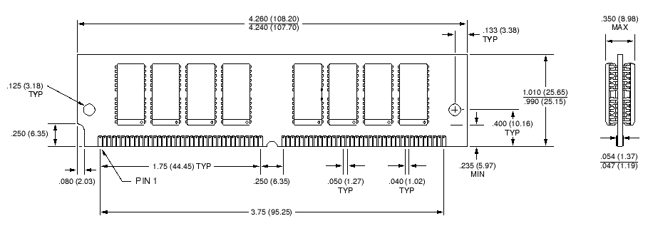

72-Pin SIMM (32MB)NOTE: 1. All dimensions in inches (millimeters) MAX or typical where noted.
