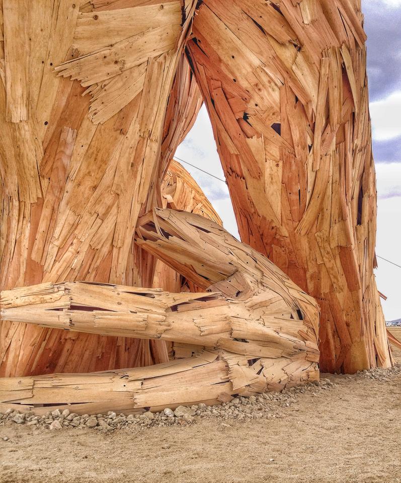

I worked on a tiny piece of the Embrace sculpture at Burning Man 2014.

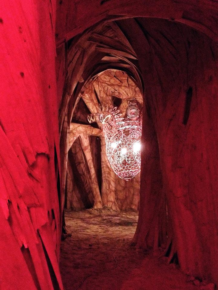

Inside were 2 hearts, one made here in Portland by Lostmachine Andy & others at Flat Rat Studios.  I made electronics to gradually fade 4 incandescent light bulbs in heart beating patterns.
These wonderful photos where taken by Sarah Taylor.
Inside the enormous sculpture were two hearts.  The blue on was built by a group in Vancouver, B.C., Canada, and of course this one was built here in Portland, Oregon, USA.
Andy wanted this heart to have a very warm, gentle atmosphere, with warn incandescent bulbs slowly fading to create the heart beat.  These effect turned out quite well.  Andy really knows his stuff!
Here’s a great time-lapse video where you can see the slow, gradual incandescent light fading as a rapid heart beat.  Skip forward to about 0:36 in this video.
