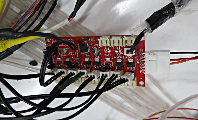

The el wires are controlled by this modified Sparkfun el wire sequencer.
This is the same board that had many problems last year. You can see in the photo 3 of the triacs blew on this board and were replaced with TO-92 through hole versions.
