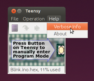

Teensy Loader has a little-known feature to show you detailed information.  Few people know of this because it’s hidden in a place nobody would look, the Help menu.
The Verbose Information window now shows events from the helper programs Teensyduino uses from Arduino, as well as the events from within Teensy Loader itself.
The events are now timestamped with millisecond resolution.  Normally this level of detailed logging isn’t needed, but when “strange” USB problems occur, a log of all the events from every software component can really help.
Teensy Loader has only a few dialog boxes.  The most important ones, alerting you to problems like the wrong board, have long been non-modal to prevent blocking event logging and responding to Arduino.  Help > About and File > Open are also non-modal, completely eliminating modal behavior.
