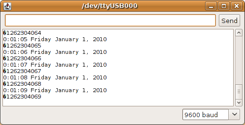

DateTime, by Michael Margolis, adds timekeeping ability and provides access to to hours, minutes, seconds, days, months and years.
Download: DateTime.zip
The example was slightly modified with a default time, so it will run without needing a separate program to set the time. DateTime works on Teensy without modifications.
Hardware Requirements
None. The time is kept using an internal timer, which is synchronized when you call DateTime.available().

  DateTime.sync(1262304000L);  // default start, Jan 1, 2010

  Serial.print(DateTime.Hour,DEC);
  printDigits(DateTime.Minute);
  printDigits(DateTime.Second);
  Serial.print(" ");
  Serial.print(DateTimeStrings.dayStr(DateTime.DayofWeek));
  Serial.print(" ");
  Serial.print(DateTimeStrings.monthStr(DateTime.Month));
  Serial.print(" ");
  Serial.print(DateTime.Day, DEC);
  Serial.print(", ");
  Serial.println(DateTime.Year + 1900, DEC);
