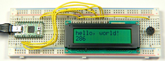

Nearly all character type displays have a 14 pin interface. Often 2 extra pins are added for power to the backlight. Pins 1 and 2 must be connected to power. A 10K potentiometer is used for contrast adjustment, with the center pin connected to pin 3. The two outer pins of the potentiometer connect to +5 volts and ground.
Slow Connection
Only 6 signal are required, RS, Enable, D4, D5, D6 and D7. The R/W pin must be connected to ground. Pins D0, D1, D2 and D3 are left unconnected.
Fast Connection
LiquidCrystalFast can use the R/W pin for faster access. Either way can update the display faster than a human eye can detect, but if your project needs to do other work, less time updating the display may be worth using a seventh pin.
Large 4x40 Connection
LiquidCrystalFast can also access large 4x40 displays, which have two enable pins.
Display using slow 6 signal connection
Basic Usage
LiquidCrystal lcd(RS, Enable, D4, D5, D6, D7)
Create the LiquidCrystal object and specify the 6 pins where the LCD is connected. You can connect more than one display (each to its own pins) and create a separate LiquidCrystal objects for each.

Example Program
This example can be loaded with File > Examples > LiquidCrystal > HelloWorld.
// include the library code:
#include <LiquidCrystal.h>
// initialize the library with the numbers of the interface pins
LiquidCrystal lcd(12, 11, 5, 4, 3, 2);
  // set up the LCD's number of rows and columns:
  lcd.begin(16, 2);
  // Print a message to the LCD.
  lcd.print("hello, world!");
  // set the cursor to column 0, line 1
  // (note: line 1 is the second row, since counting begins with 0):
  lcd.setCursor(0, 1);
  // print the number of seconds since reset:
  lcd.print(millis()/1000);
