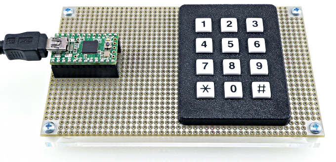

More Hardware Pictures
![]() Bottom side wiring, 7 signals between keypad and Teensy |
